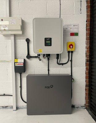

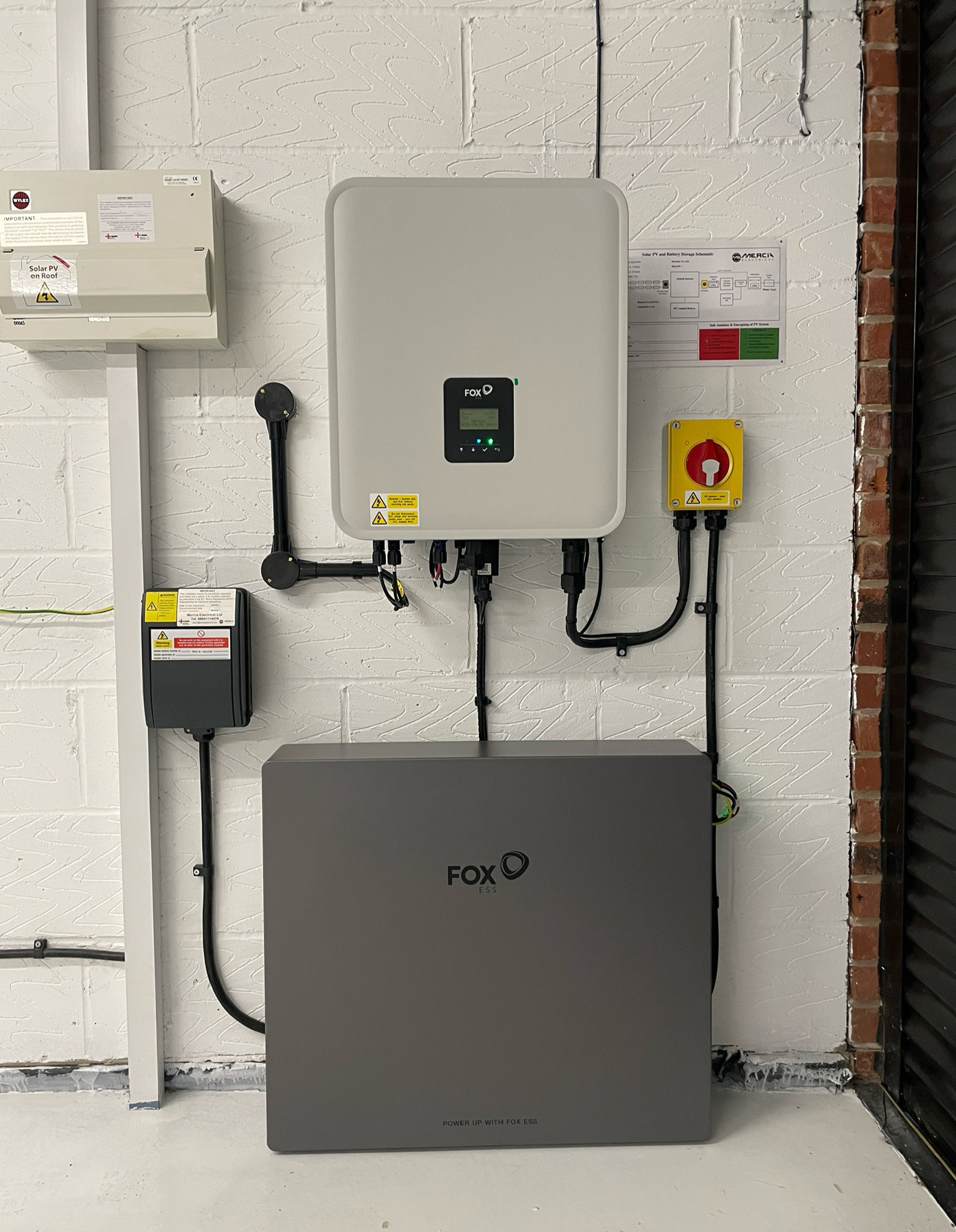

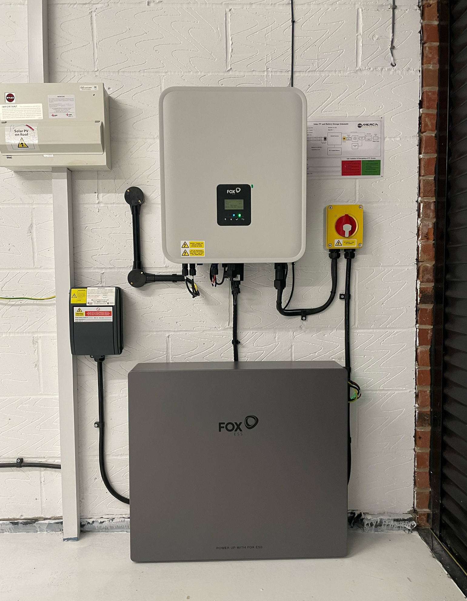

FoxESS KH-7, 7.05kWp, EP11 Battery, NW England
Realised I never posted an entry here. Installed October 2025.
FoxESS KH-7
7.05kWp, S/SE facing (15 x Aiko Neostar 2S 470Wp, split into 7+8)
EP11 Battery
100A PME service
Very happy with the system now. Performing above expectations. Some initial issues with firmware but all resolved now.

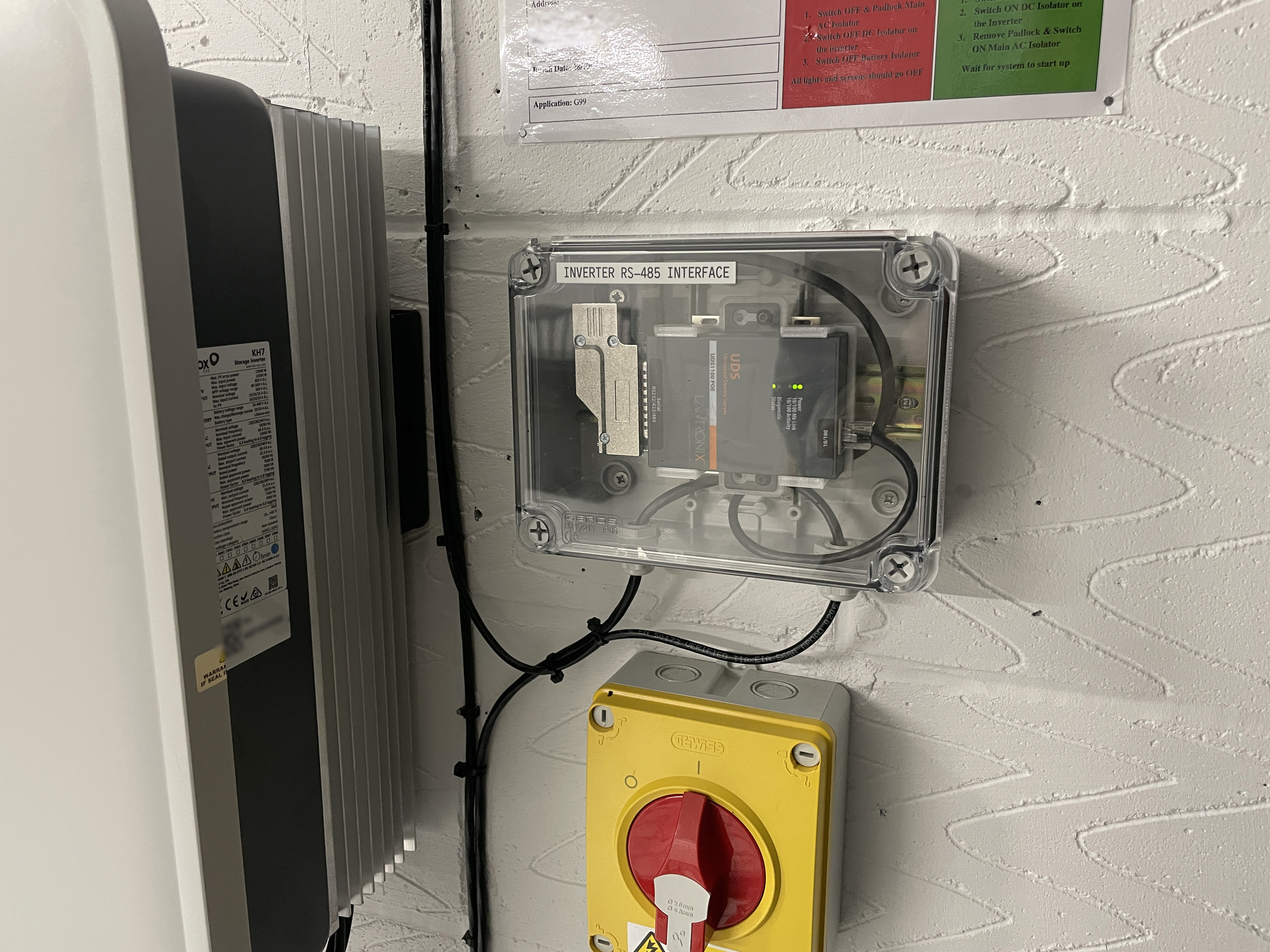

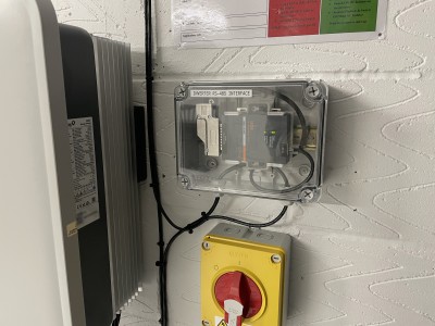

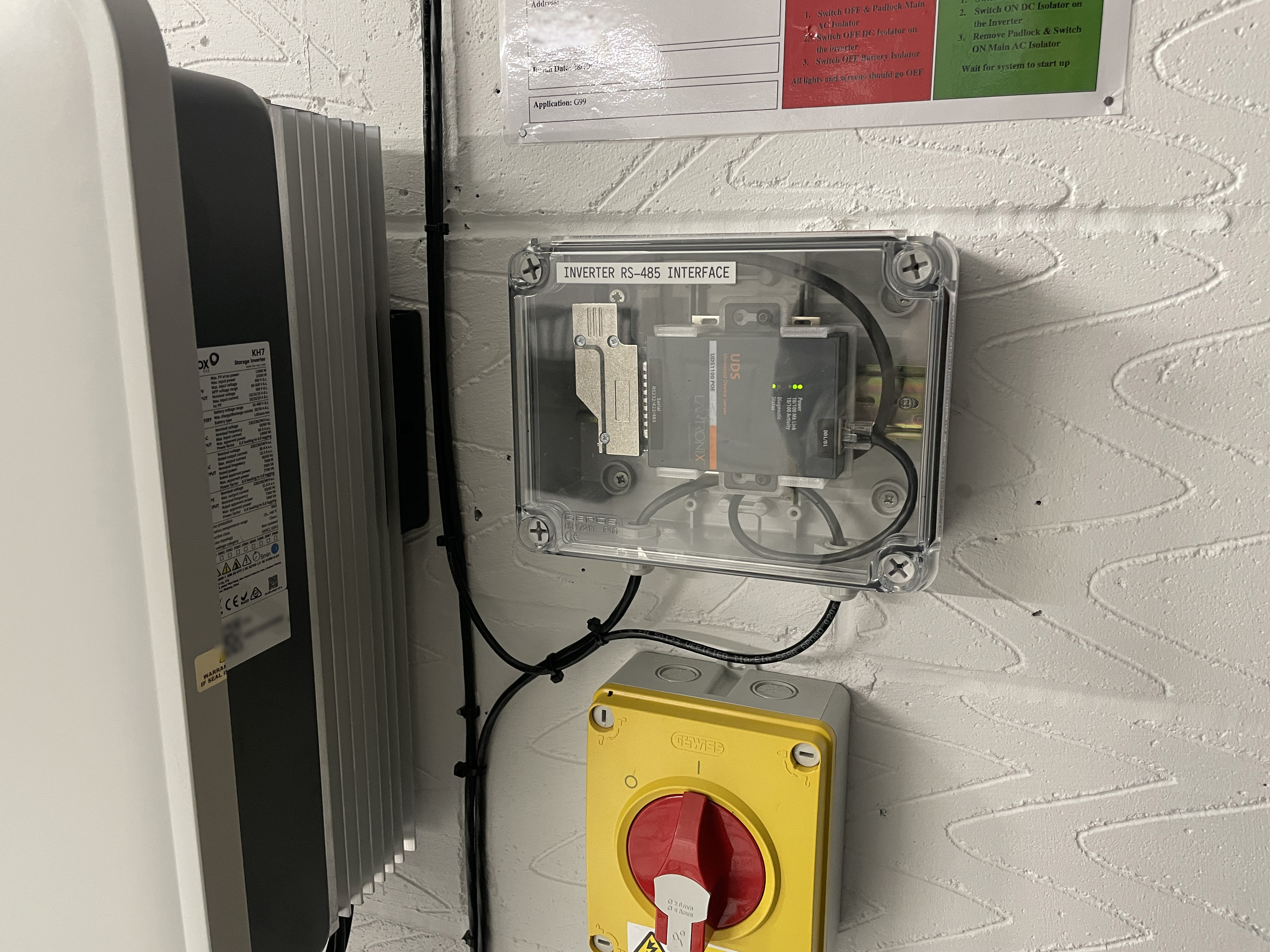

I also added a PoE-powered Modbus interface using a Lantronix UDS1100 for the system to link with Home Assistant.
