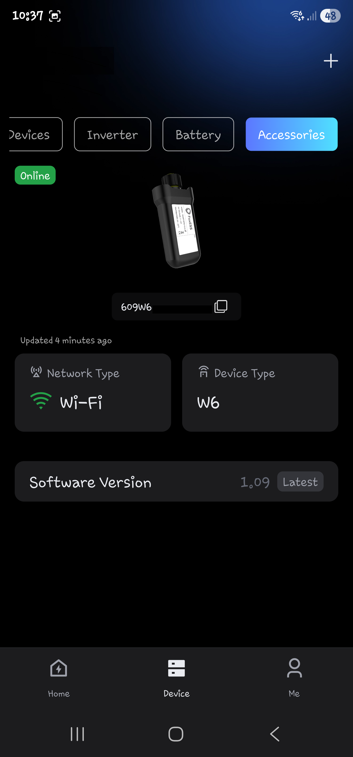

1st attempt failed (no error code)
2nd attempt it took
Is your datalogger frozen or still responding?
Re: 41206 error when updating W6 datalogger firmware from 1.08 to 1.09 via app
Many thanks :-)
Everything still working on 1.08 since the failed update to 1.09. I didn't try retrying it since I wanted to see if anyone had feedback, but if a retry worked for you, then it's worth trying again.
Retry succeeded - modbus updates to home assistant working, but it doesn't seem to be talking to the app now, with 1.09. Curious. Not an immediate problem but might become one. I'll check the wifi settings to make sure they weren't lost.
I lost comms too with the new version, I tried to swap WiFi networks as I have 2 available.
I set it to a new SSID, and nothing.
Rebooted system, and it came back.
The app started to get data again, so I swapped SSID's back to original one, but not sure if it needs a reboot to take it.
