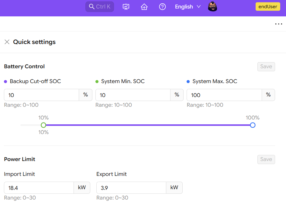

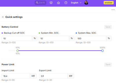

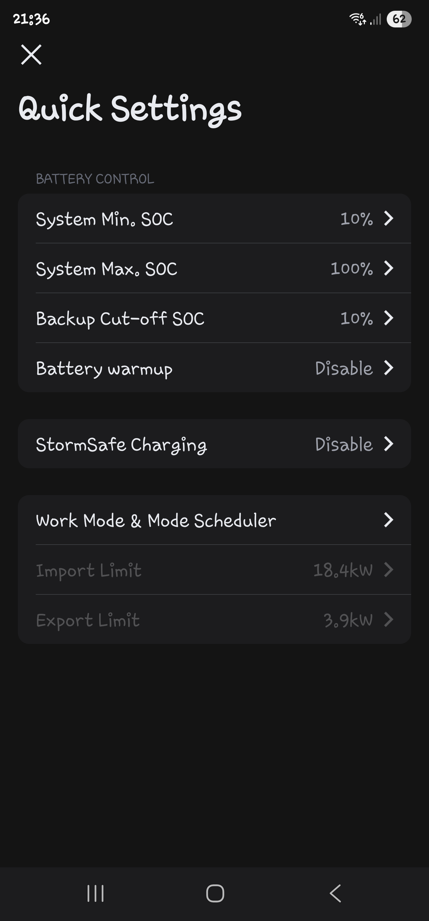

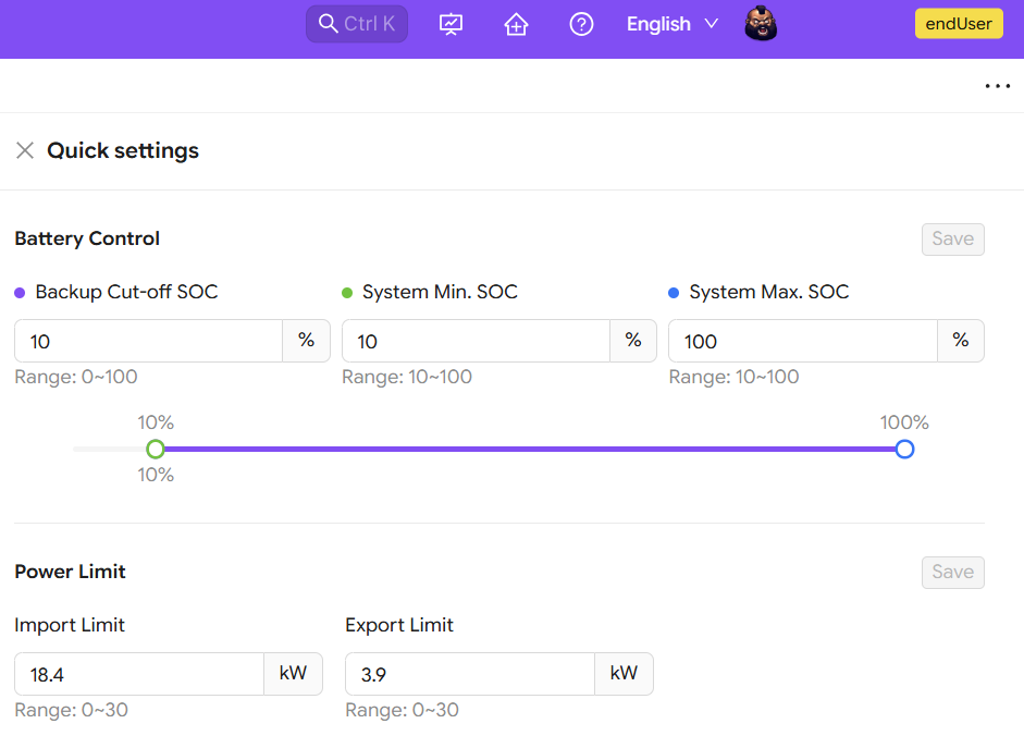

I was looking at the https://www.foxesscloud.com/v2/login tonight and noticed that you can adjust the export limits with an 'endUser' account, that is blocked if you try this in the FoxCloud2.0 App.
Before this is fixed, it can be a useful bug to work around changing the export settings without going to the Inverter.
Website before

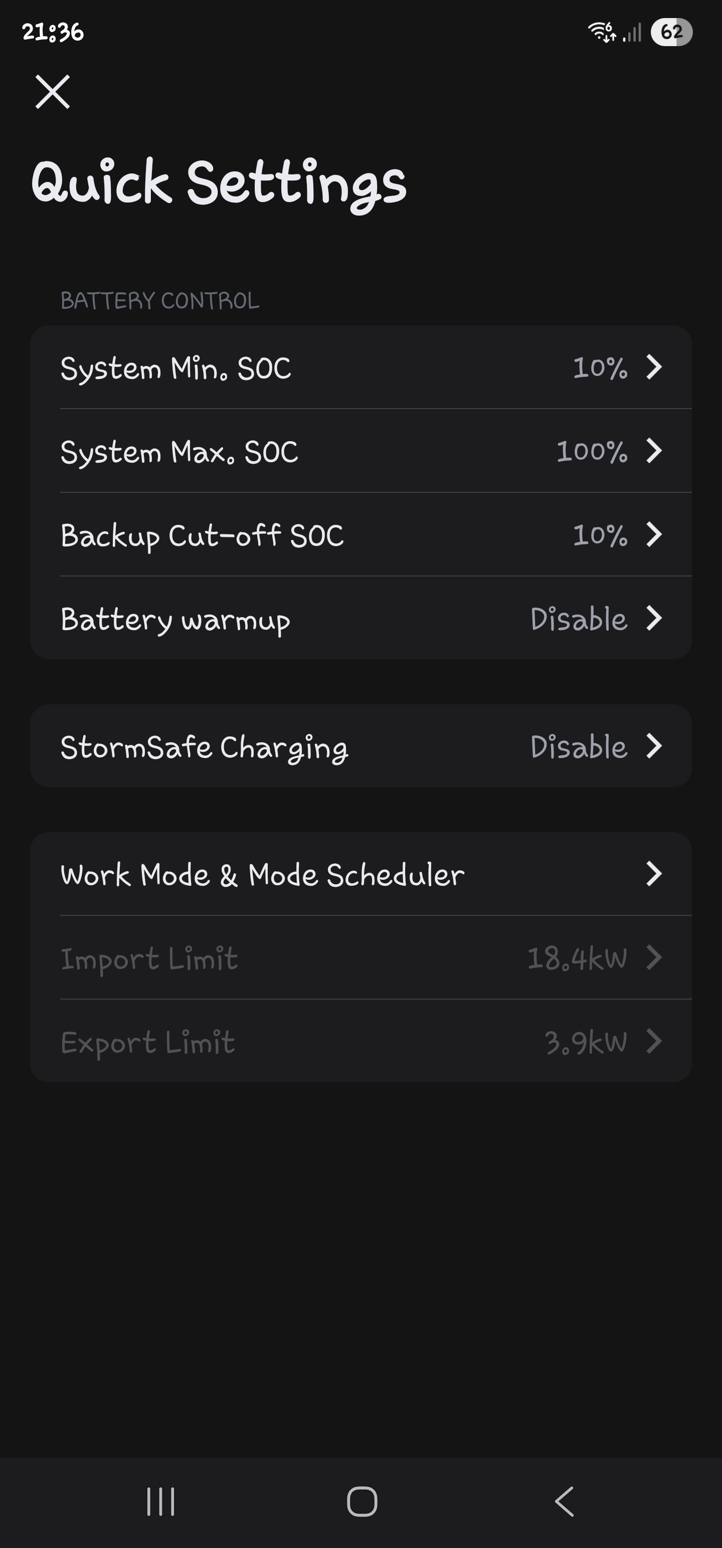

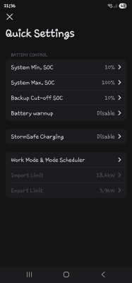

FoxCloud2.0 before

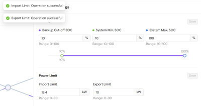

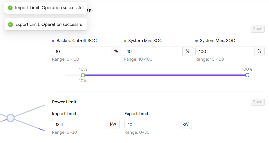

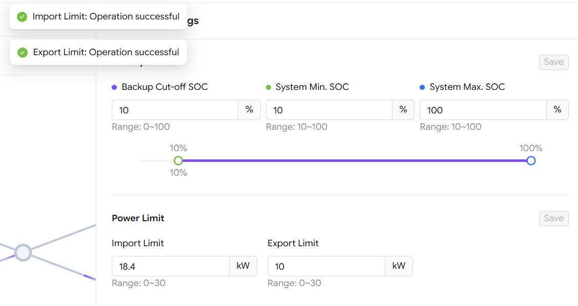

Website after

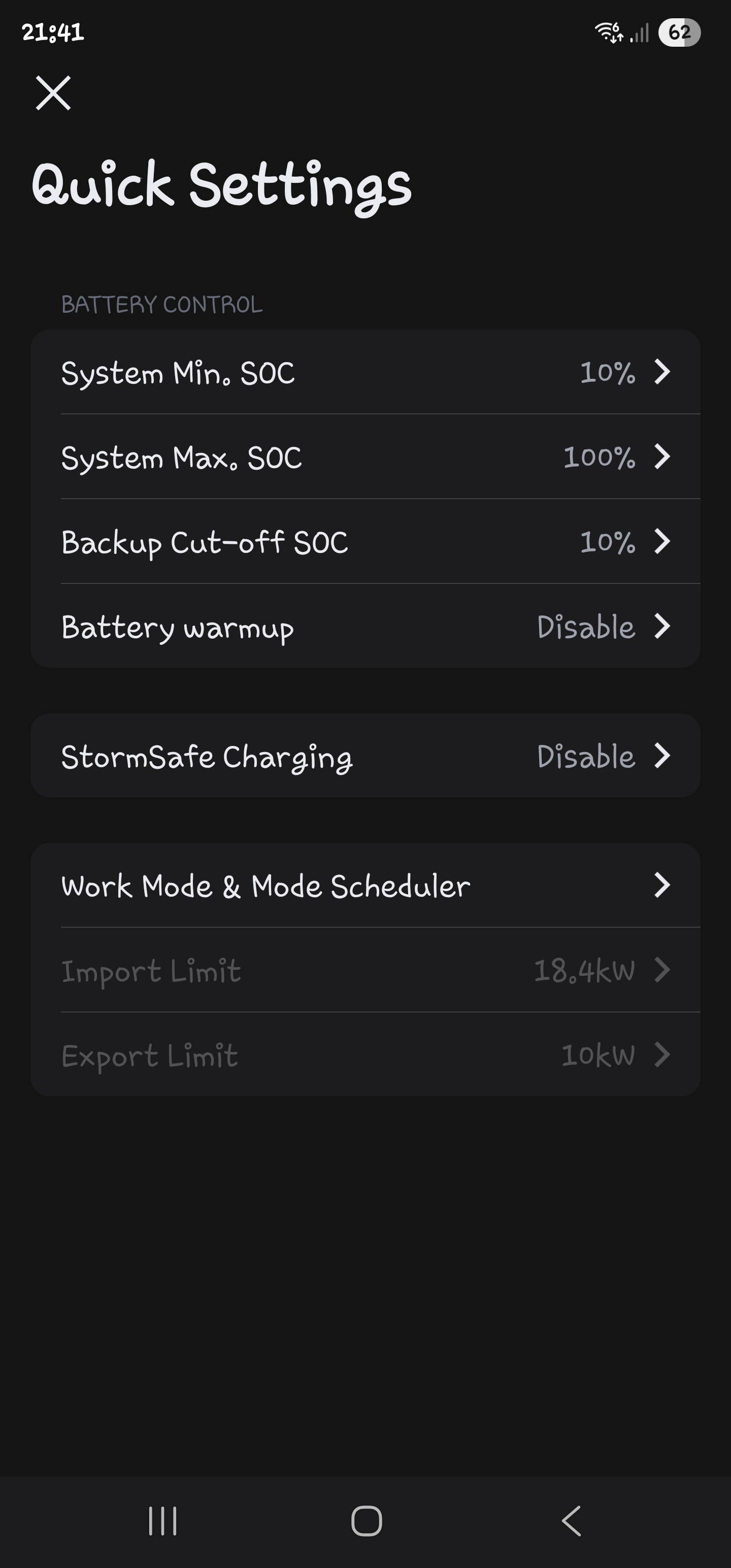

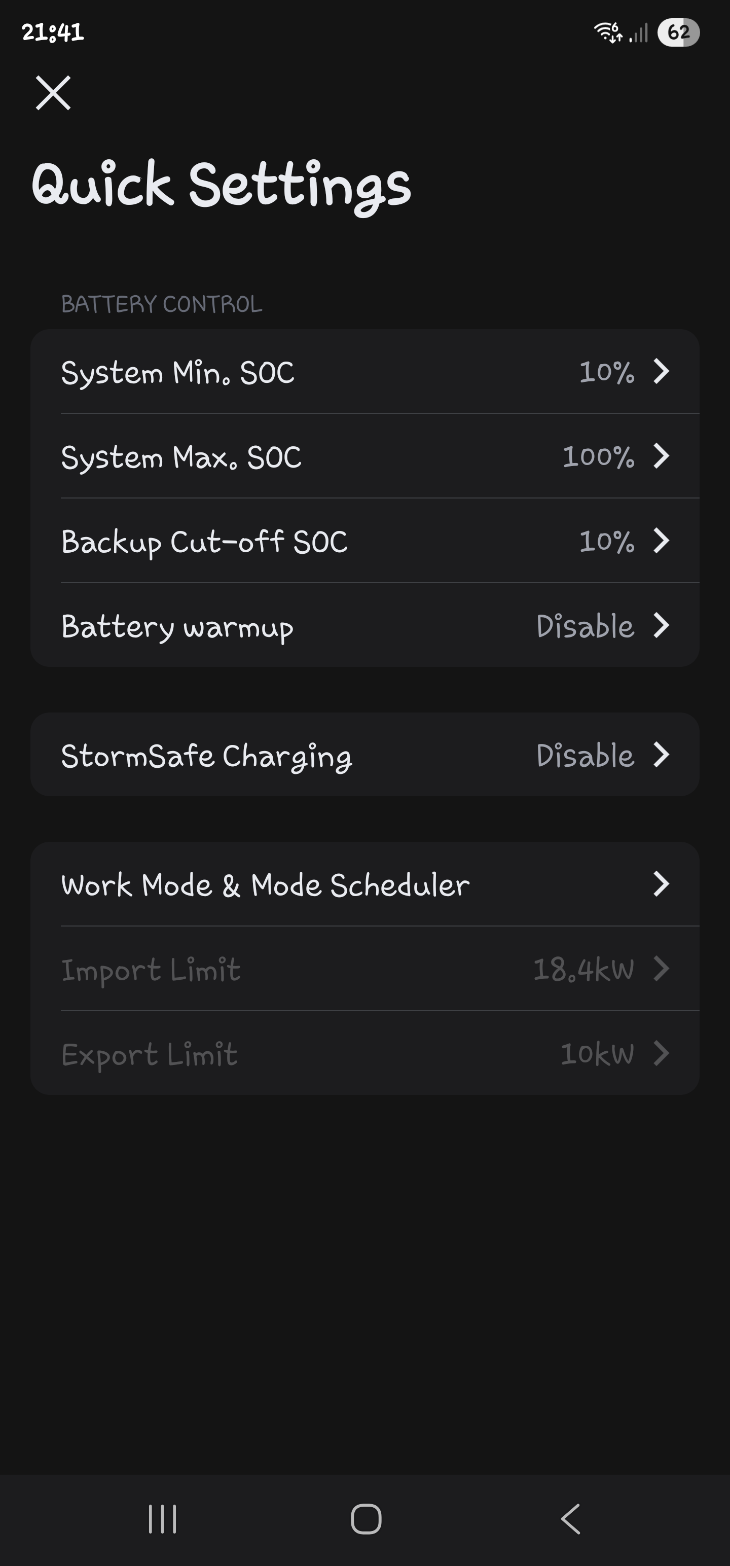

FoxCloud2.0 before
Video capture of a force discharge, I have a KH7 and it only wanted to export at 5kW, a pause of the video, and I set the export back to my correct 3.9kW
