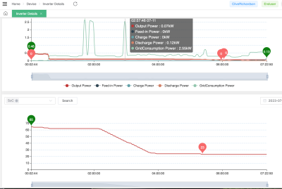

My battery is discharging overnight, although I have the system set to not discharge, as per the recent change in software settings, between 00:30 and 07:30. The SOC reduces from about 65% t0 25% over a period of an hour and a half, from about 02:00 but looking at the overall stats, the rate of discharge is constant during the 00:30 to dawn of about 0.12kW (not sure why it's not zero as it is set at). The discharge does not change when usage peaks (dishwasher comes on) but remains constant. The battery is 4 x HV2600, 2.6kWh units so this 40% discharge represents about 4kWh, not the 0.6kWh represented by the 5 hours at 0.12kWh shown discharge.
Could one of my battery modules be faulty? How do I check?
screenshot of the general graph and the SOC graph

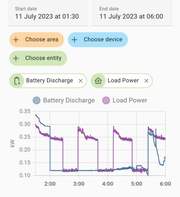

I'm seeing the same thing - a constant discharge of ~120W when it shouldn't be discharging at all.
Interestingly 120W is my base load (with the fridge compressor off).
Here, the no-discharge period is from 2am to 5am.

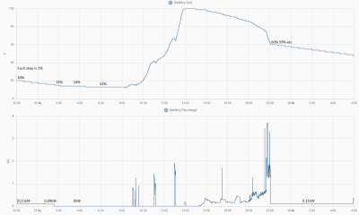

Curious. My system (which usually seems to be a magnet for all possible weirdness) is showing no discharge other than when expected:
