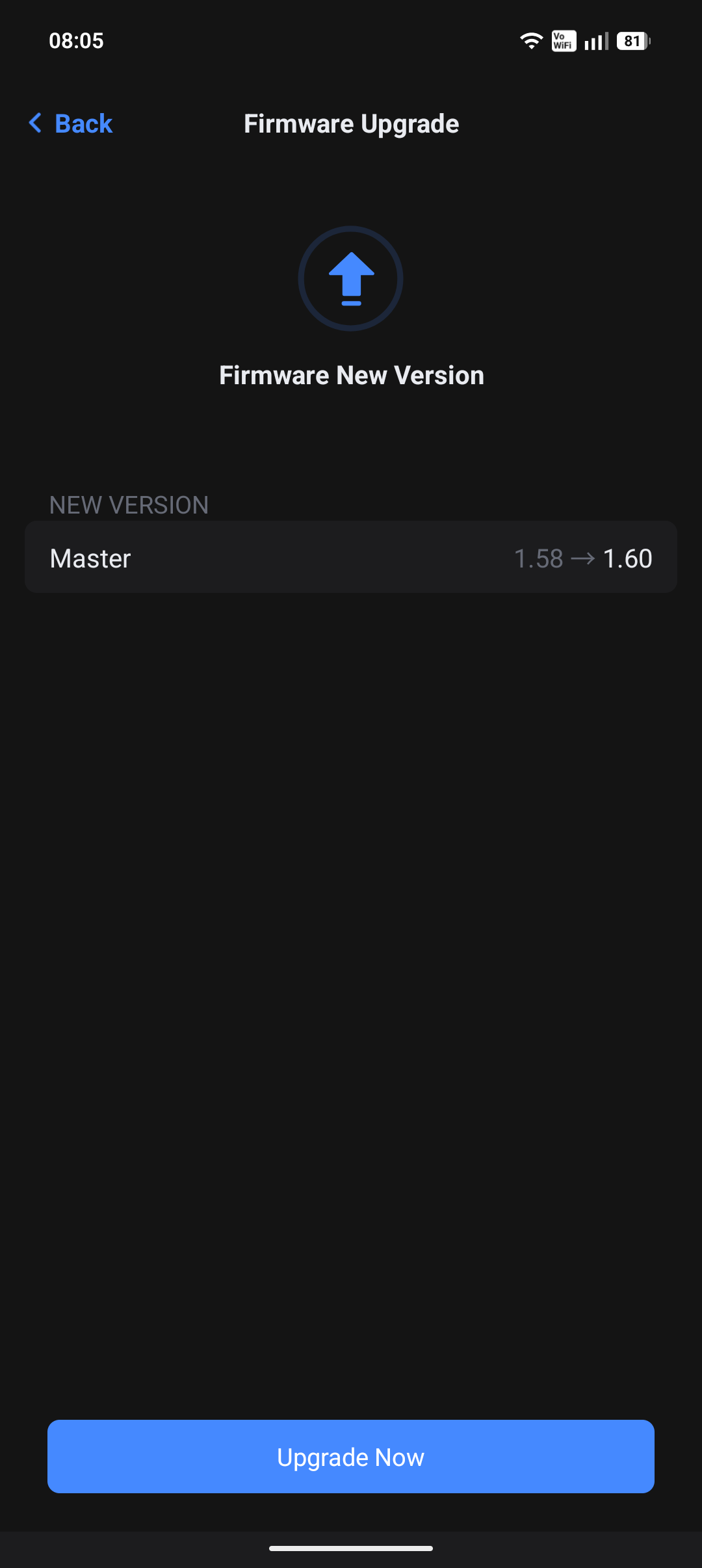

Could you confirm whether my KH9.9 uses a single data-logger/Wi-Fi device based on the attached screenshot showing the “Upgrade Now” option in the app? I would like to proceed cautiously with firmware updates to avoid any risk of bricking the device, and that is why I am looking for thre release note for the version 1.60 in case it is not essential to do.

If you can see data in the app and/or web portal, then AFAIK it can be remotely updated.joezhouq wrote: ↑Fri Mar 13, 2026 10:56 pm Could you confirm whether my KH9.9 uses a single data-logger/Wi-Fi device based on the attached screenshot showing the “Upgrade Now” option in the app? I would like to proceed cautiously with firmware updates to avoid any risk of bricking the device, and that is why I am looking for thre release note for the version 1.60 in case it is not essential to do.
If you aren't feeling particularly brave you may need to hang out for a bit until someone posts about their experience when they did ok the update, or if the update was was triggered by Fox and they had no choice in the matter.
As for bricking it, if it's an official update and not some hacked third party version, you should be covered under Australian Consumer law, although it'd still be an inconvenience until it was fixed.
