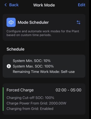

Can you post an image of what settings you use for the charge, i.e. is it a force charge in a schedule or a charge period ?
Re: System has stopped charging 100% overnight
I have added a screen shot of the settings used

What size battery do you have?
Those 3hrs would gain a max of 6kWh.
Ok thanks,
how big is your battery ?, at a 2,000W charge power it would only get a max of 6kW in the 3 hours allocated - previous firmware versions ignored the 2kW and charged at the maximum rate which might be the reason you are only getting to 60%

I have 10kwh battery capacity.
If the old firmware ignored the max charge rate - that would explain why it got to 100% before, and I certainly see a higher rate in early February.
Thanks all - I will increase the max charge rate tonight and see how it goes.

Update
Having increased the max charge rate setting, all is working well again now and reaching 100% charge overnight again.
