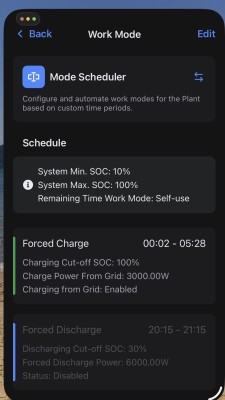

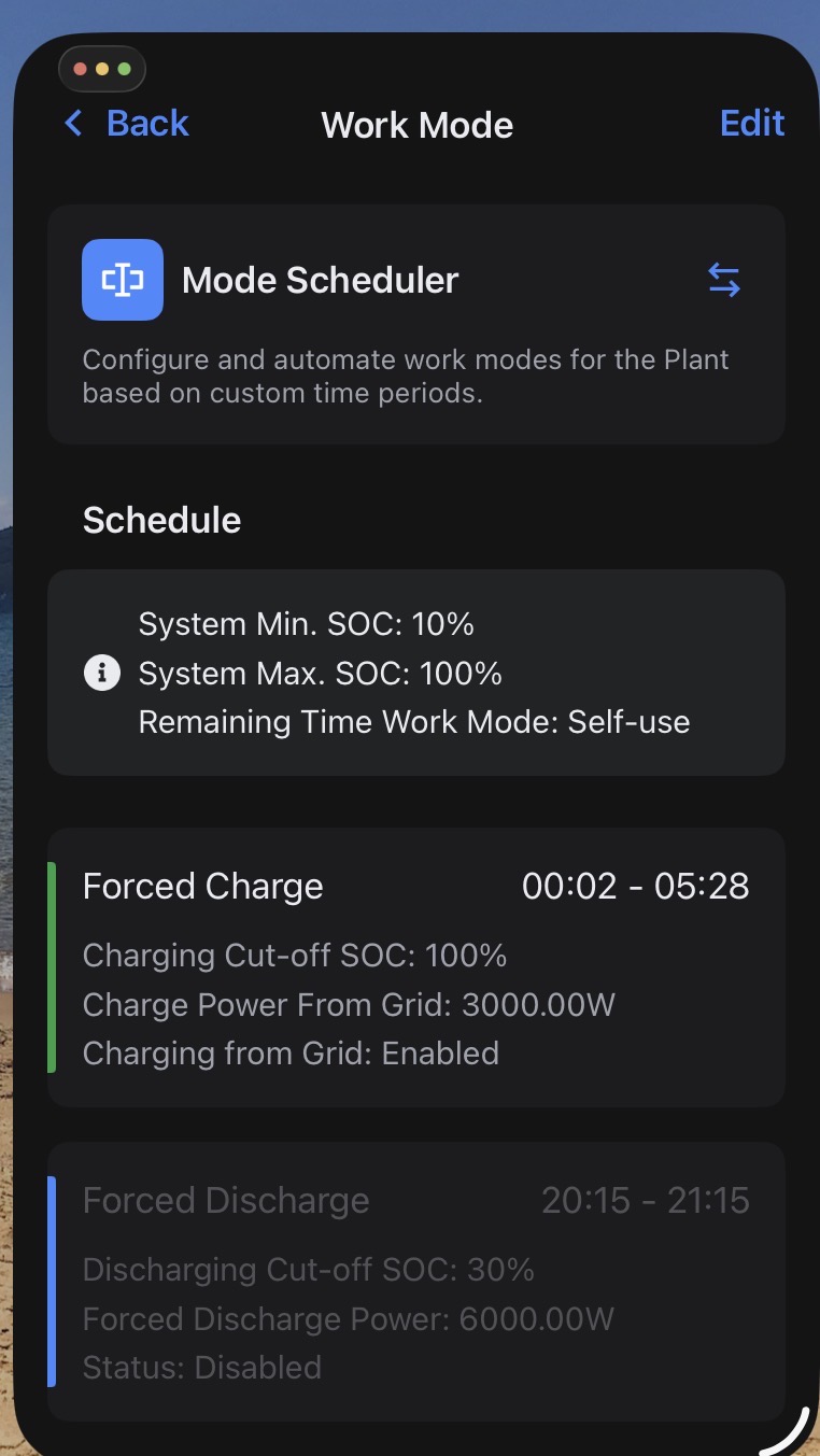

For what it’s worth my app is 2.2.2. and is set as image below, and works exactly how most people want it to, house load, charge battery then export when full and solar excess available.
It grid charges every night as set.
