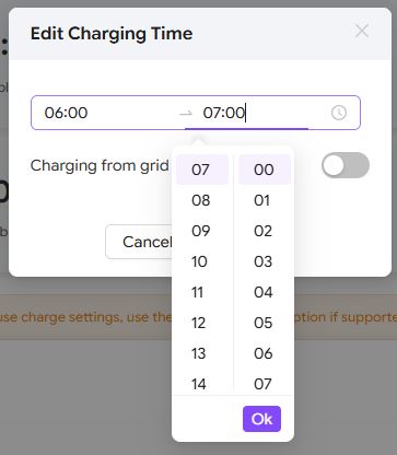

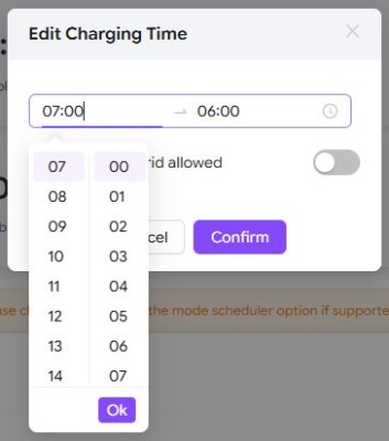

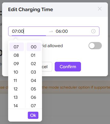

The issue is with the foxesscloud/v2 web interface. When I enter the required times, the interface swaps them and puts 05:30 as the start and 23:30 as the finish! And I've tried with other start/finish times too. It just swaps them so that the start is before the finish.
As soon as I click OK, Then it swaps the times and focus is set to the end time,
