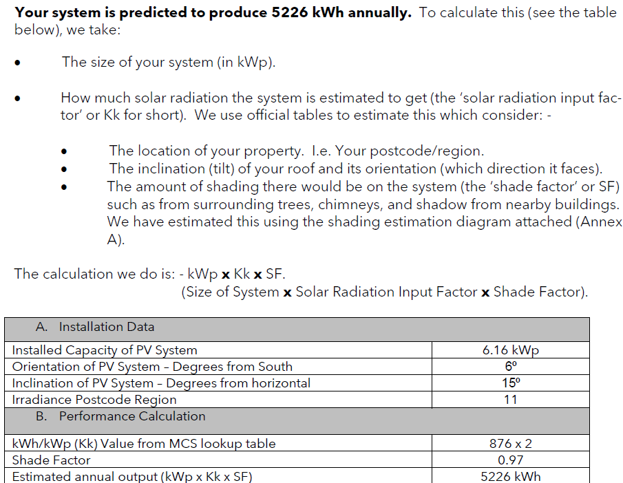

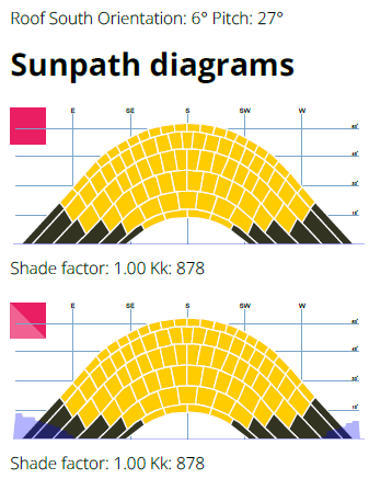

I agree that long term picture is what is best for your system.
Meanwhile, do you have something like this in your quotes for your system?
I am curious to your values for a possible comparison (the other day the 16kWh guess was done with your size of system to mine)

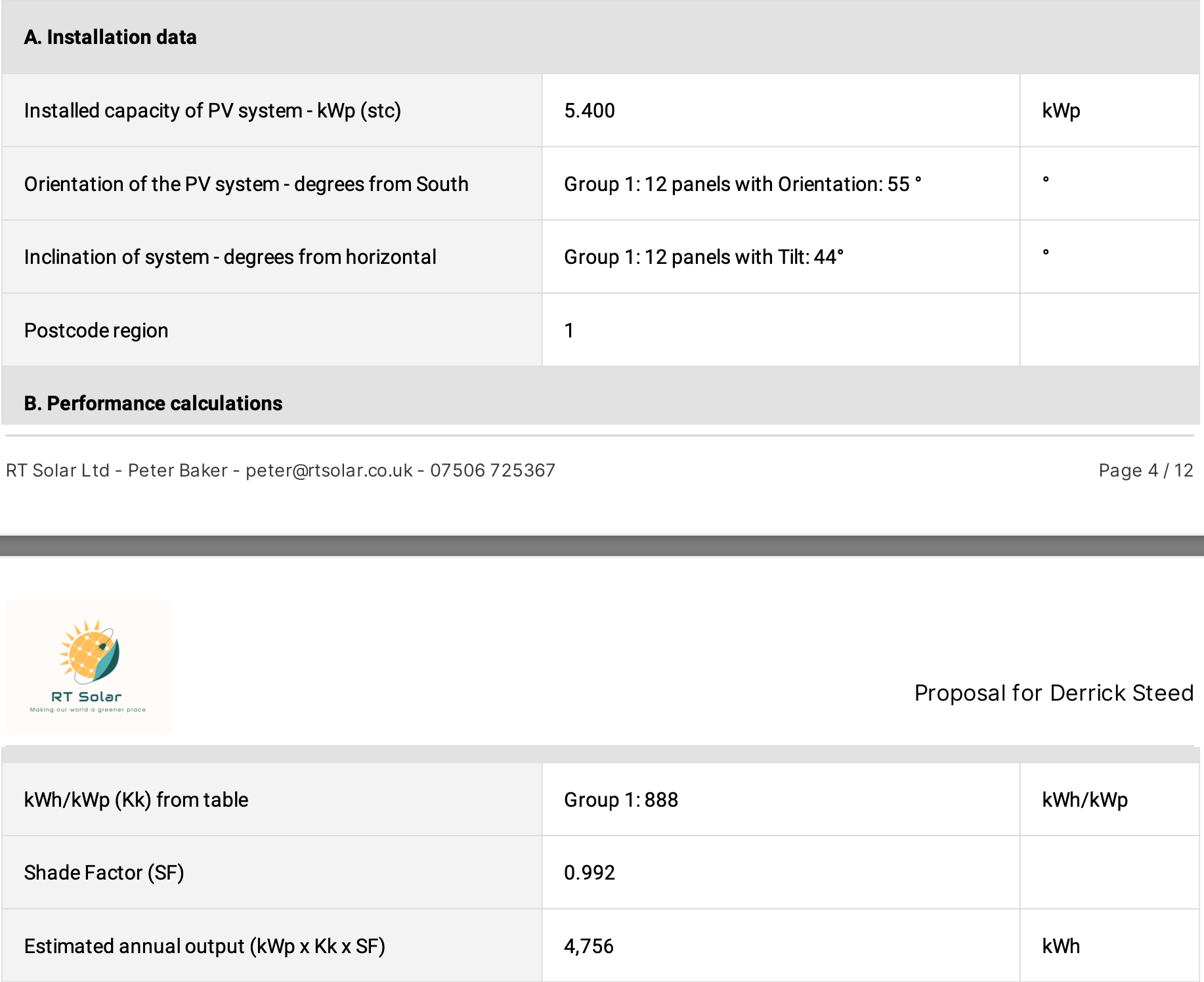

Hi MB,
Yes I have a very extensive table with similarities to yours:
There are some foibles with it - although the proposal cited 12 panels on the roof, when the roofer made detailed measurements after he was able to access it via the scaffolding he refused to install them due to MCS guidelines compliance issues (in his view) so I agreed to having the remaining two panels put on the garage.
There are some other orientation foibles:
Degrees from South I put at 60 degrees - I know this because I did a little bit of astronomy some time ago and knowing where North is helps in finding Polaris.
Inclination I put at 40 degrees by checking the angle of the joists.
The irradience postcode is a nonsense to me - neither your 11 nor my 1 looks anything like a postcode.
The shade factor is obviously off a bit due to the garage panels, but that was my OK on that.
The annual output estimate is a "Well, we'll see about that" given the garage panels but so far the system seems to be going quite well given what it's produced so far (387kWh) against consumption (about 1.2MWh).

I was looking to compare your possible output annually 4756kWh compared to mine of 5226kWh, and this gives a 91% rough comparison.
It is hard to compare cloudy days, but once you get a full day of Sun on your panels, where your PV output looks like a whale, and if I had the same uninterrupted sunshine, the theoretical 91% should translate.
So if I made 10kWh, you should have made 9.1kWh.
It is all fag paper maths, proof will be in your results.
The irradience postcode is a lookup table for MCS calculations, Scotland will get less sun than Devon, so the Country is divided up into bands of lattitude.

It's just a regional grouping, defined by the MCS. https://mcscertified.com/?standard=irradiance-datasets
So for example someone in the south-west will have higher irradiation than someone in Aberdeen.
Nothing to do with actual postcodes so I don't know why they called it that.
Thank you WyndStryke!
Initially the 1 and the 11 still make no sense when referring to the table unless one sees that the table has numbered tabs (per location) and row/column values per tab - so reading from the table under Zone 1 - London, the value at the intersection of row 43 (slope = 40) and column o (orientation = 60 from South) I get an irradiance value of 879 from it, but I am not in London! and I assume that it would be possible to interpolate values read from the intersection to deduce an irradiance value for my location. MB could then read his irradiance value from the row/column intersection under the tab for his "postcode".
So, on the assumption that MK lies midway between London and Birmingham then the irradiance value is (839+879)/2 = 859. That alters the projected figures I was given based on the Open Solar report. That's a little over 2%! I'm shocked (NOT).
Many thanks for your help, the veil is lifting.

Post Code Zones are real, I dug this out this morning.
Page 5
https://epvs.co.uk/wp-content/uploads/2 ... ide-v2.pdf
And combined with the dataset of 21 regions
https://mcscertified.com/wp-content/upl ... asets.xlsx
Page 5
