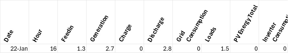

I did a little experiment this afternoon and watched the generation meter at 1645 (i.e. after sunset here but when the system was in forced discharge mode). The meter was flashing and recording generation activity. The Energy Stats app for the same time yesterday (which was cloudy and rainy so little or no PV generation possible) recorded the following. The energy stats app suggests there was no PV generation but there was generation activity (presumably this correspondes to flow through the inverter, caused by the forced discharge). Thoughts?
