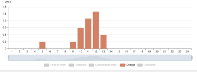

I've attached a screen shot of the charge per hour (the sun has been out pretty much since 0800 and the batteries got to 100% charge at around 1230). The columns only add up to 4.7KWh, when the theoretical maximum of 3 x HV25 is 7.35KWh, so I'm pretty certain the new battery isn't being charged. I know that I can only use 80% of the total capacity (or 90% if I reduce the Min SOC to 10%) but surely I should be storing somewhere around 6.9ish KWh on a very sunny day, as today has been. And, as I say, the batteries stopped charging at around 1230 and I started sending back to EDF.

Right, let's try again!

What was the SoC of the battery when you started charging it today? Worth noting that 80% of 7.5 is 6, assuming your minimum SoC is still set to 20%...
Given that all the battery modules won't have been balanced on install, the BMS would most likely reduce its assessment of how much charge can go in, which could explain at least part of the difference you're seeing. Also worth noting that the batteries achieve their rated capacity at 25C, I'm guessing if you're in the UK it'll be a bit cooler than that.
Lastly do you know what firmware versions you're running? You can see this on the front panel of the inverter in one of the menus (sorry I can't recall where off the top of my head). If you're running an older firmware this can mean that you don't get the full capacity because the SoC tracking is off.
I'd ask your installer to ensure the latest firmware is installed, and also try the battery balancing procedure outlined above...
