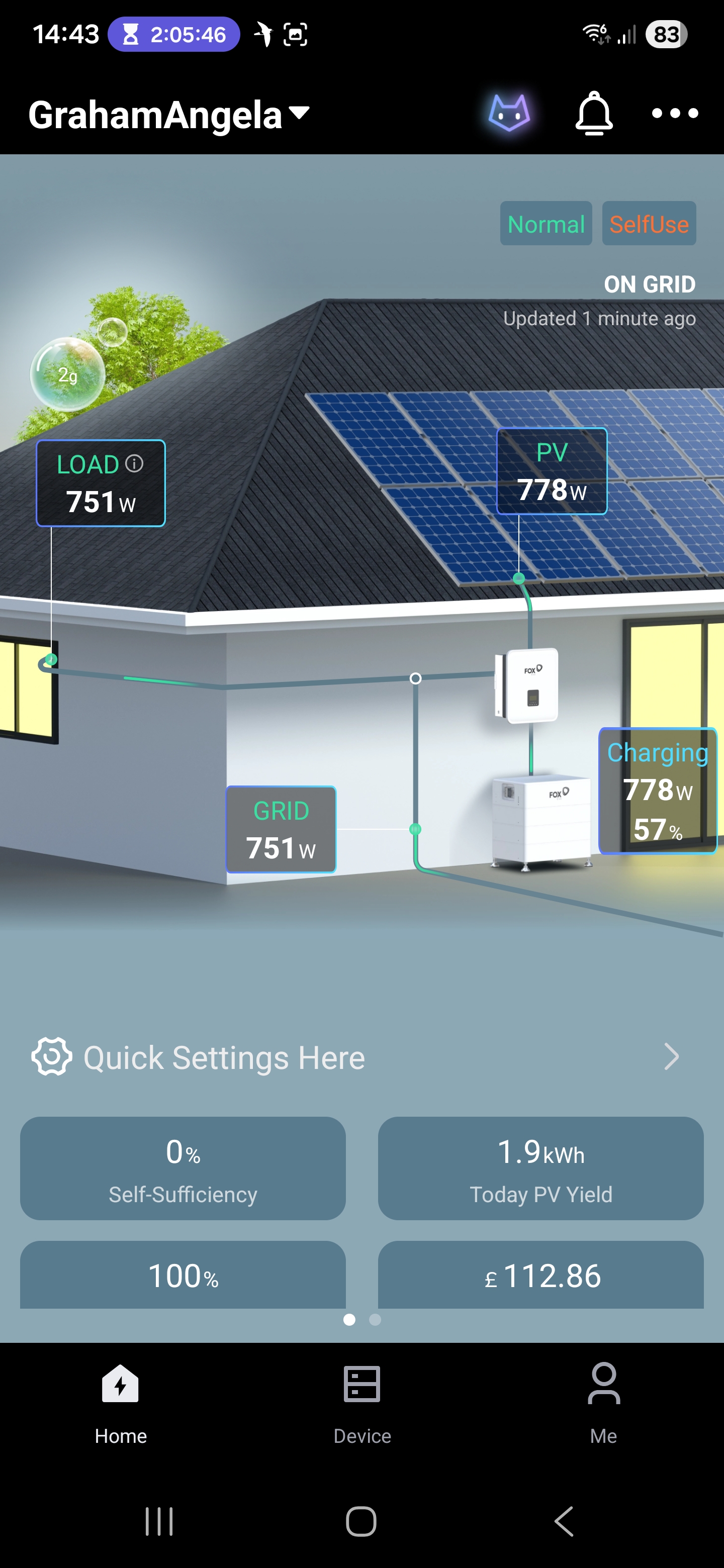

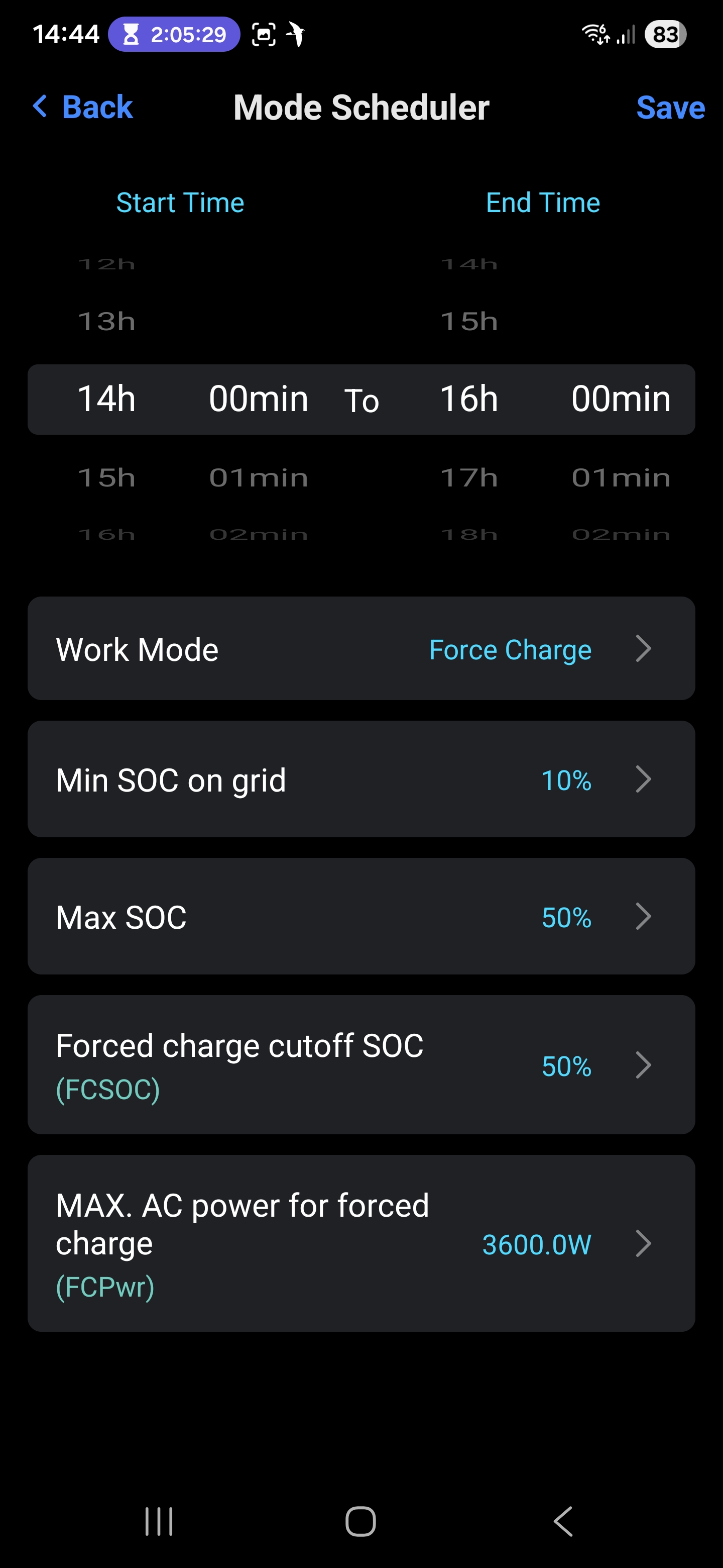

Currently, if I use a scheduler to force charge my battery to 50%, it just keeps charging past the set SOC. I'm pretty sure this didn't happen before the most recent update.
My schedule and usage are shown below. You can see that I've set the Max SOC and the Forced charge cutoff SOC to 50%, but even though the battery is at 57%, it's being charged by my solar panels, and the house is being charged by the grid, which is not what I want. I'd expect that once the battery met the 50% cutoff, then the house would be charged by a combination of solar panels and grid, until the end of the schedule, and then revert to battery use.

It looks on the surface that your schedule is working in the sense that once it gets to a 50% SoC it then is reverting to Self-use mode. The Self-use mode is deciding to let your battery charge to 100% and not function correctly either.
