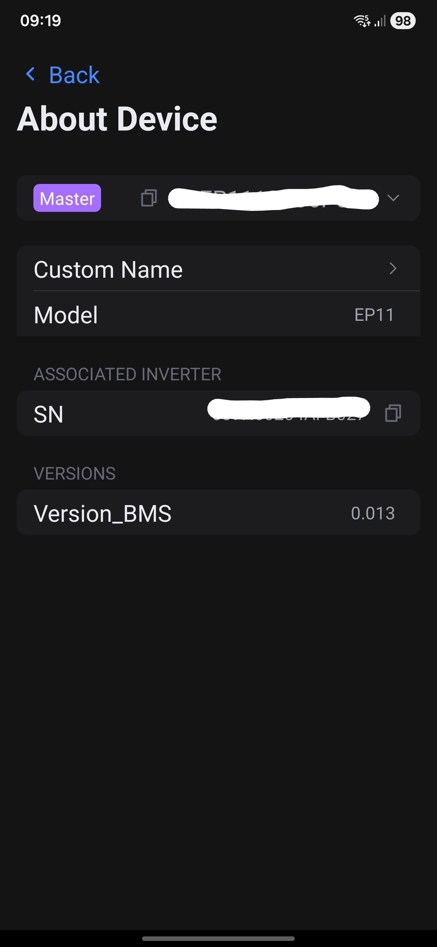

Anyone else received firmware version 0.013 to replaced 1.011 - EP11
As the title suggests, has anyone else received 0.013. I have an ongoing ticket with Fox, and they "upgraded" my firmware from v1.011 to 0.013 .. although, in my head ... that version number is a downgrade
I queried this with the Fox support person I am dealing with, and she advised "It is correct, the file name can be different sometimes" .... but this just seems strange
Re: Anyone else received firmware version 0.013 to replaced 1.011 - EP11
He is correct in saying the filename for the flash can be EPv1.013.bin for example, but the program that wrote the firmware file had a typo for the version string value (what appears in your picture above)
Someone basically did a typo is all, this will be a newer FW based upon the filename given at the factory, just the internal value is screwed up by human error is all.
