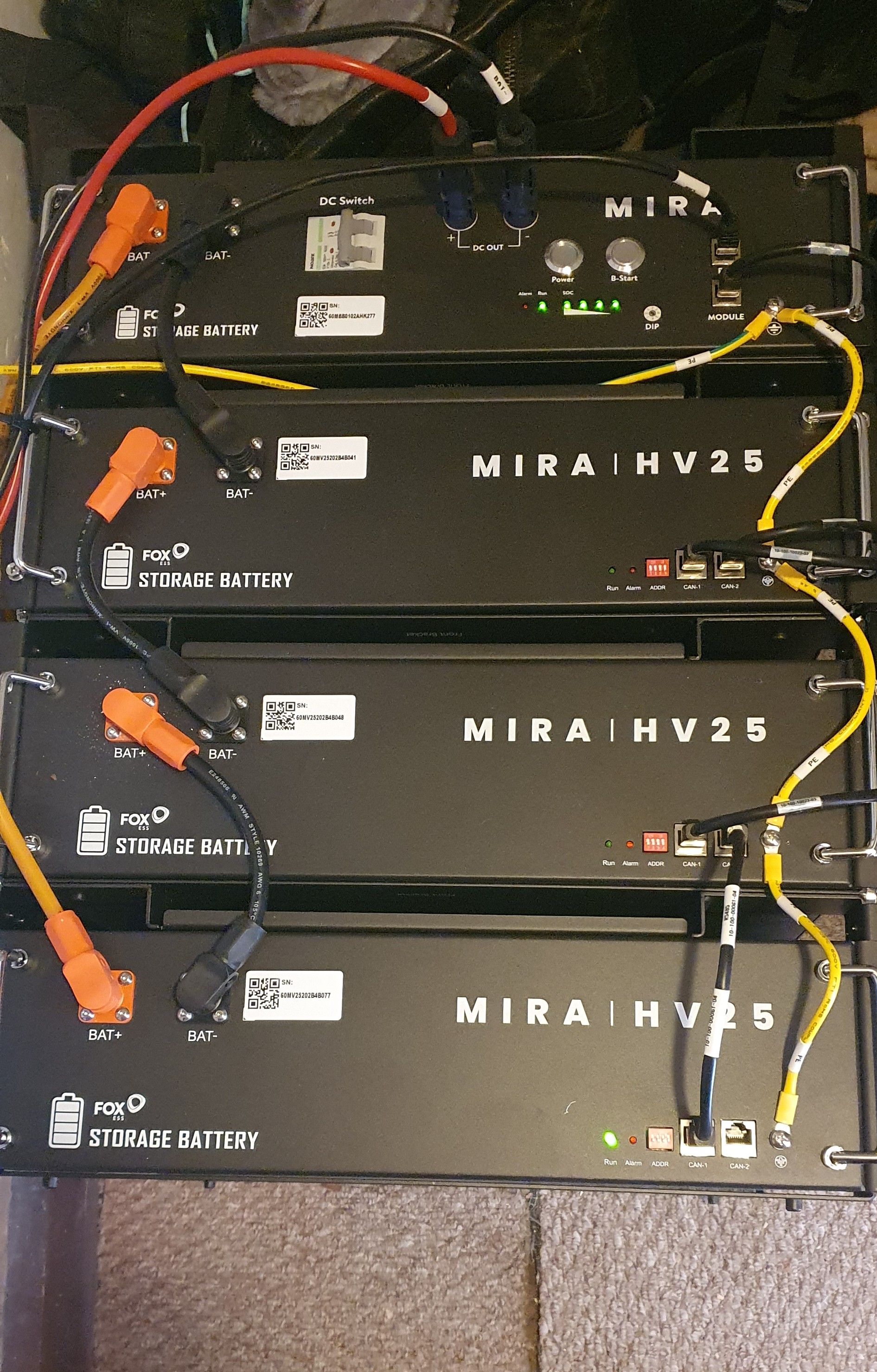

Hi, I asked my installers to add another HV25 battery during our install and now I have Home Assistant I'm pretty sure the extra battery hasn't actually been activated - although lights are on etc.
I have 3x2.45 batteries and HA is saying that FoxESS - Bat Charge is 4.9kWh (whilst app/cloud saying 100%) - that looks like it thinks there are only 2 batteries?
Can someone please advise? Can I restart the BMS maybe? The installers suggested look on this forum.

First thing to do is peak to installers.
I assume the extra battery is linked correctly (batteries are in series, so +ve to -ve between batteries), then the coms cable (Cam1 to Cam2) and set the dip switch to 1 as in 1 extra battery.
Make sure you do it with inverter and batteries powered down and ideally at same or similar charge levels.

Thanks for the response. I'm confident it's all wired correctly and the dip is at position 1. I'll try to restart the bms and think need to restart inverter too. Do you agree that it looks like only 2 working?
I will go back to the installers if can't resolve it myself.

update: Restarted BMS and the inverter and even forced charge from the grid (someone here mentioned rebalancing) but it still says 4.9Kw at 100%. I've asked installer to send someone around but willing to try and other suggestions. thanks.

My only other thought is to try the new battery with one of the old ones and set dip switch back to 0. i.e. just use 2 batteries as a test, 1 new 1 old. See if the new battery works correctly then you know if you have a duff new one?

It's fixed or at least getting better! I trawled many places and found lots of people were doing force charge between empty and full with no joy but it was Will from this forum who said need to do full-empty-full. I was missing the last force charge. I did that overnight and now at 6.2kwh. More power! I've been on just 2/3 power for 4 weeks! I would never known if I didn't try Home Assistant. Installers should know this really.
I think it should be 7.35 or at least over 7 taking losses into account so will try again once it has emptied again and let you know.
This balancing issue could do with being a guide on the forum maybe?

it all seems to be working now - the battery got to 6.2 at 5 this morning then during the morning discharged a bit and then charged up back to 100% and the figure is now 7.7 which is more than expected but I'm not complaining
