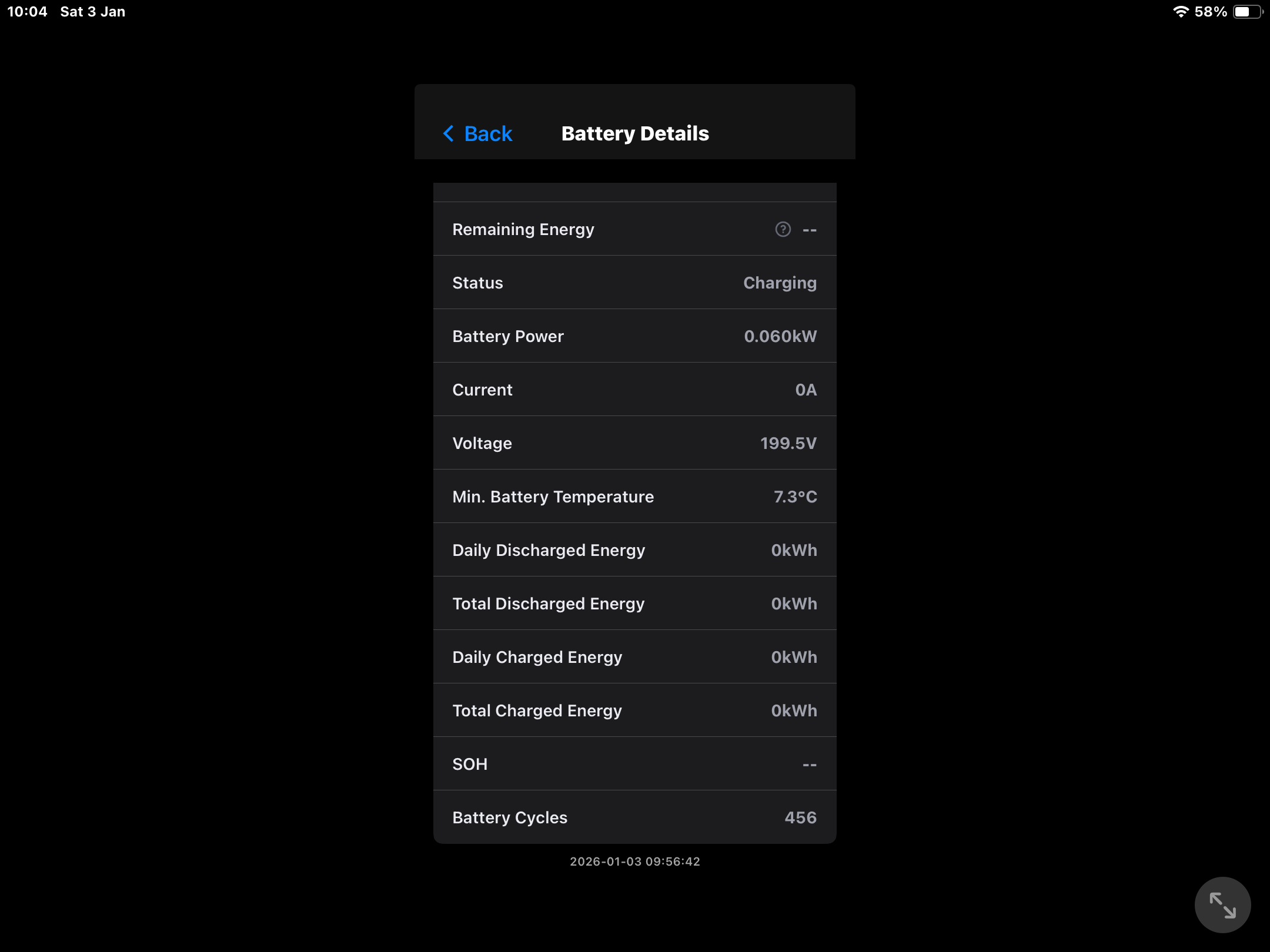

I have a EP5 battery which has been installed for 18months and working faultlessly, however the app only shows limited information:
Firmware version 1.003
Any thoughts please?
I think you have half-answered your own question, your firmware is 1.003 and current is 1.011.
Contact your installer or email Fox Support directly (with your issue/request and serial number for Inverter given)
Thanks, I wondered if this was the case.
Will I notice any other significant changes with the updated firmware?
I suspect you won't get much in the way of obvious changes other than values might now be picked up in the app.
You might also wish to upgrade your actual Inverter at the same time.

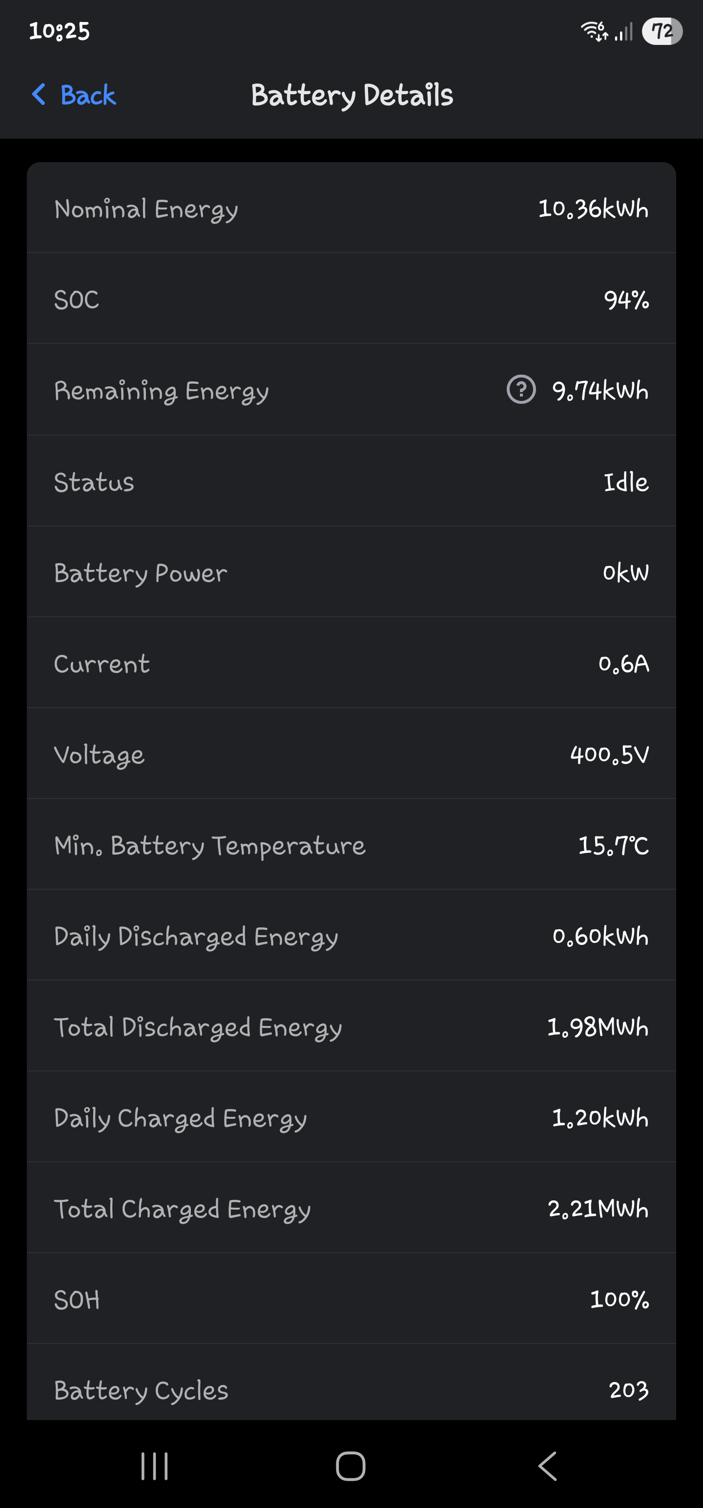

Here is what it could look like after upgrade
Best of luck with your update
