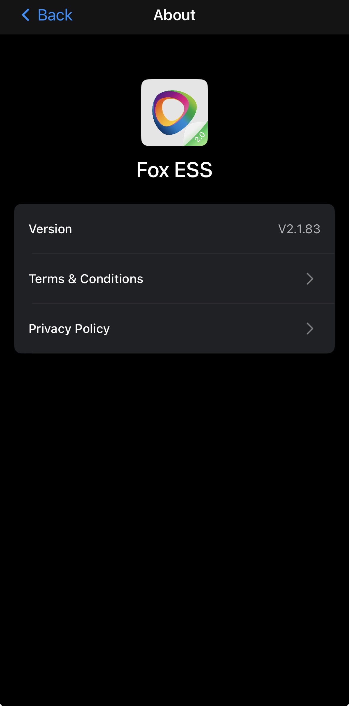

Firmware version of the app included for reference.

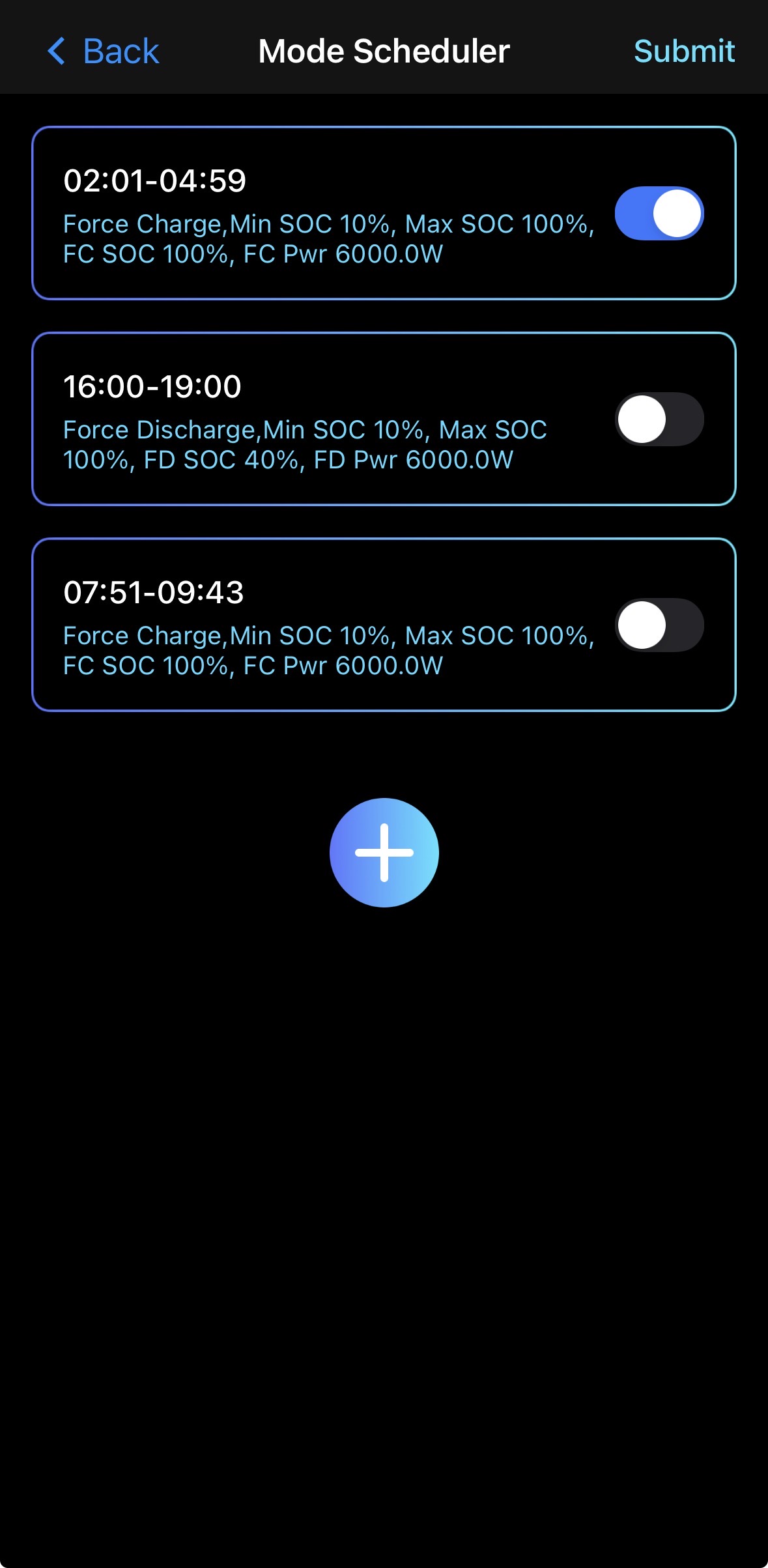

Can you post a photo of your schedule so we can confirm it's set correctly?
We just have the one charging period in use at the moment for cheap rate charge overnight. It has worked for a week since the firmware update. We haven’t changed any settings since, only viewed the data in the app.
I remember seeing your scheduler from previous thread, it all looked ok then, as it does now.
