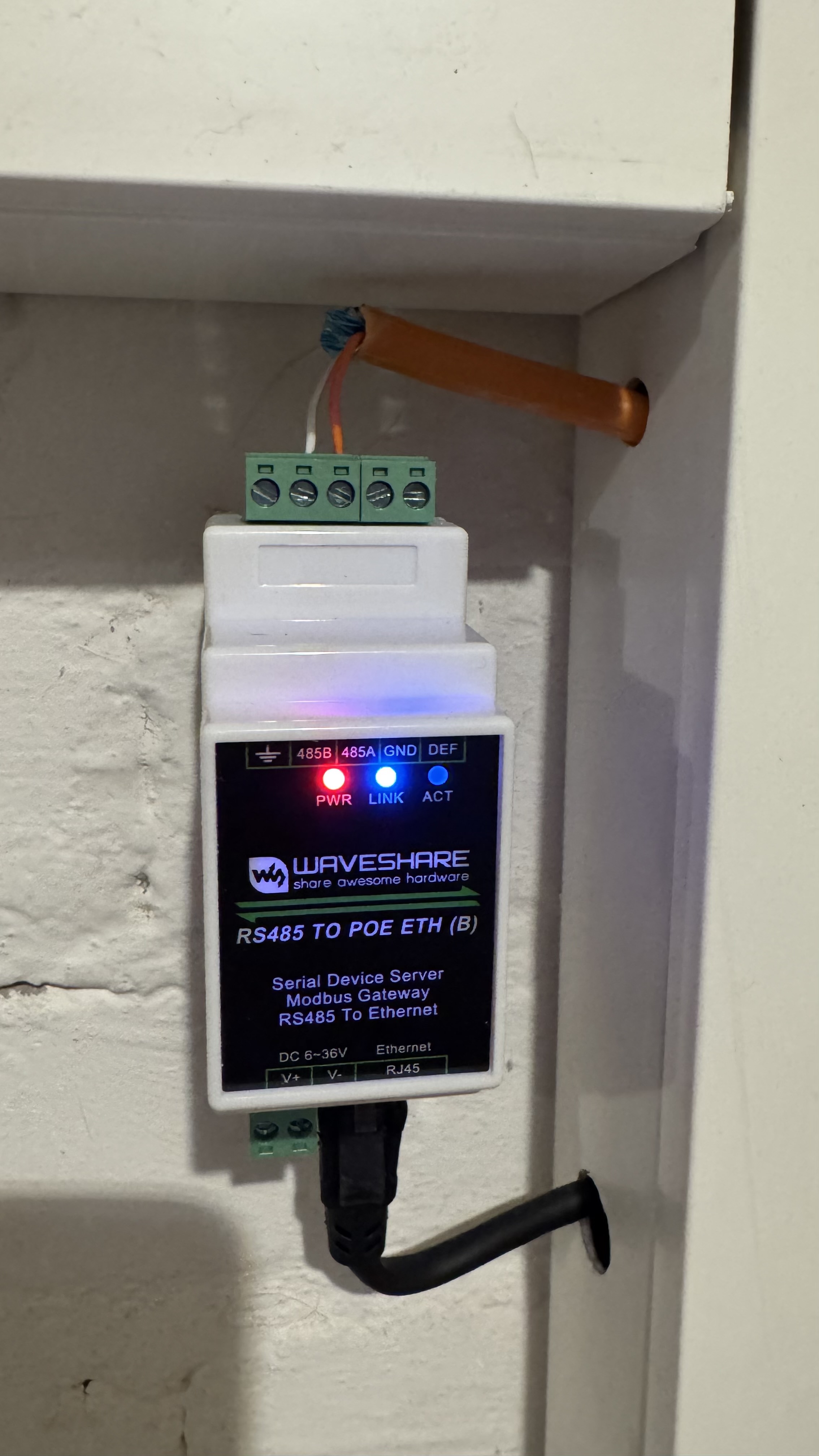

I've just had an H3 inverter installed, and I'm struggling to get it talking to HA.
I've got a Waveshare RS485 TO ETH B unit, which is wired up to the comms port and is on my LAN. I've also got v1.14.0b3 of the foxes_modbus component.
I'm adding it as an "Ethernet to Modbus/RS485 Adapter" and using the "Waveshare Modbus RTU Relay" option. Protocol is Modbus TCP, port is 502 which matches the Waveshare setting, and the inverter slave ID is 247
Normally, the LINK light on the Waveshare is solid green. When I attempt to configure the component, I'm seeing some activity on the Waveshare: LINK goes solid blue, ACT blinks green, and then turns solid blue.
After about 10 seconds, I see the "No response received, expected at least 8 bytes (0 received)" error message.
Is there something obvious that I'm missing here?

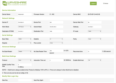

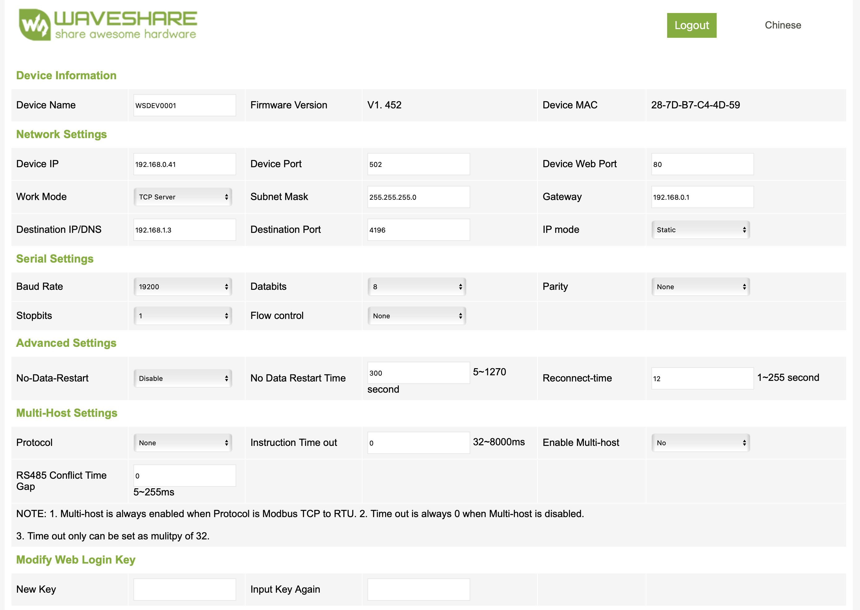

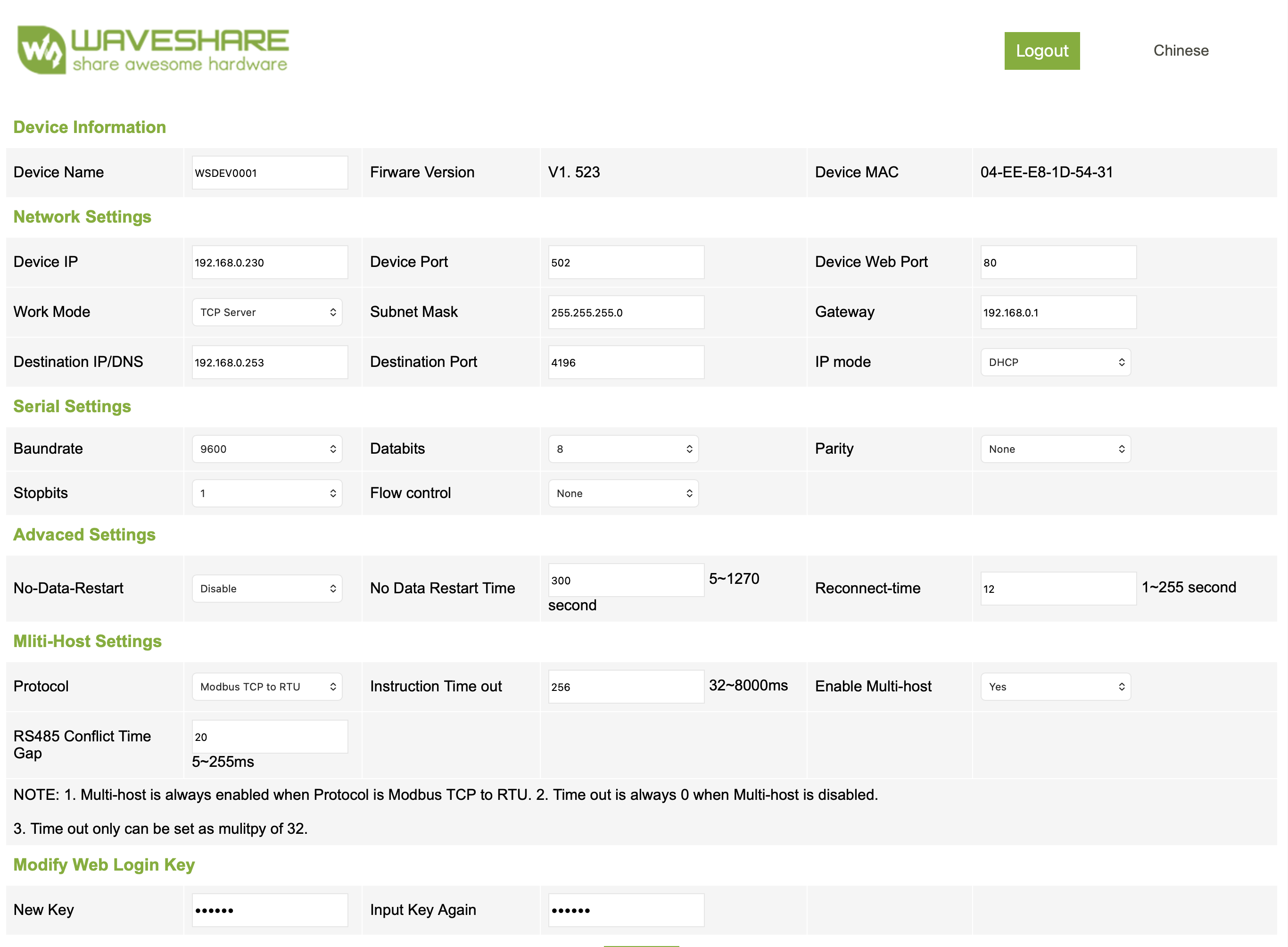

I can’t see the setting on that page for protocol it says ‘none’ but should say modbus TCP.
One thing for sure you have the baud rate set to 19200 and it should be 9600.
The ACT light usually flashes as it is addressed, solid on typically means you have the A/B wires crossed - it should be A>A and B>B

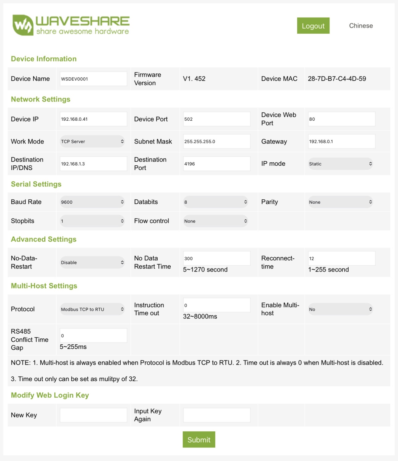

These are my working settings, it's connected to a H1(G2) but the settings should be the same for a H3

Thanks, y'all - it was a combination of missing the TCP setting and the baud rate; fix those, and data's flowing perfectly

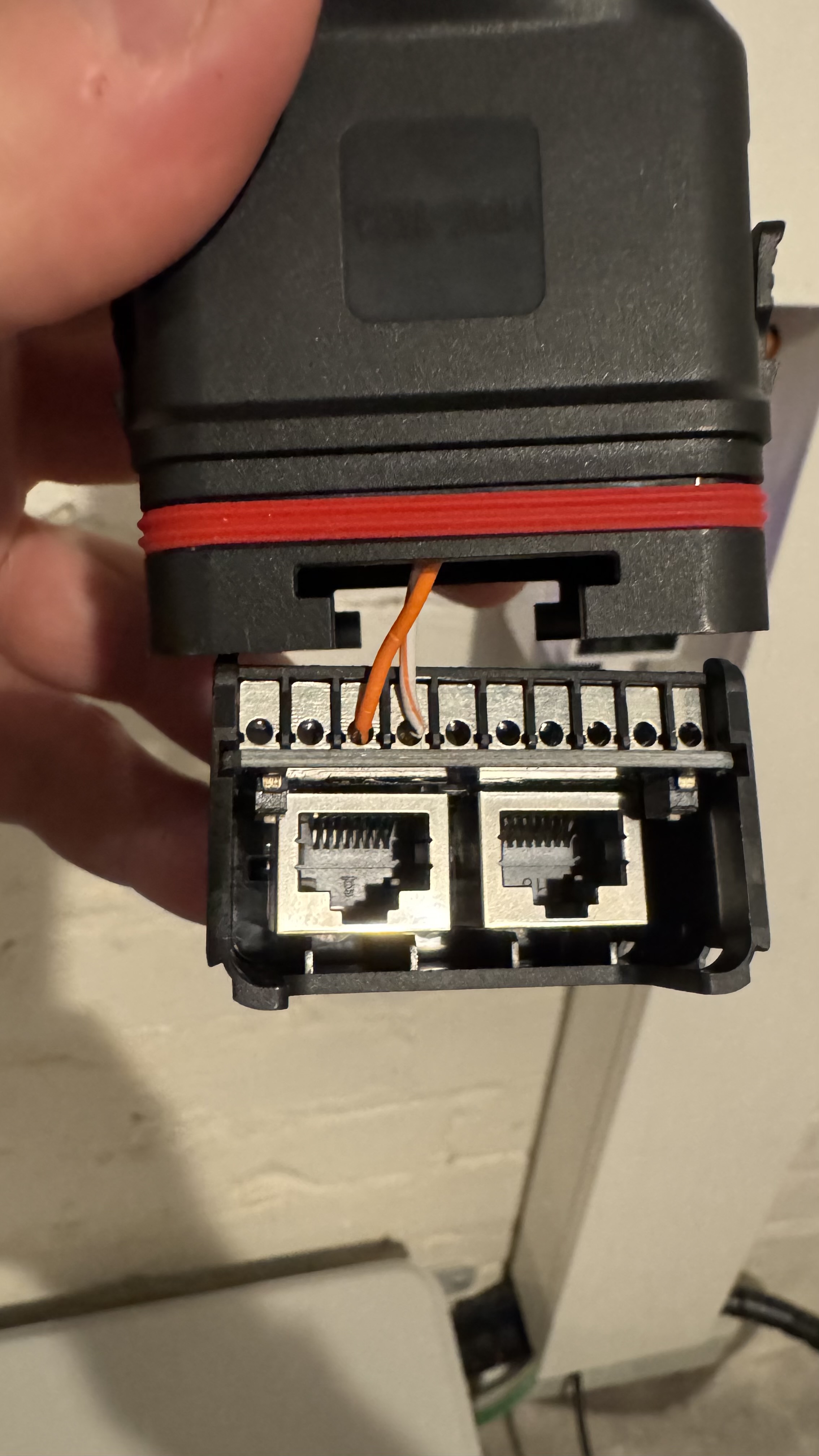

May I ask where exactly you connected your wires to the inverter?
In the big COM port or did you use the METER port that is an RJ45 port?
I'm struggling to get mine to work

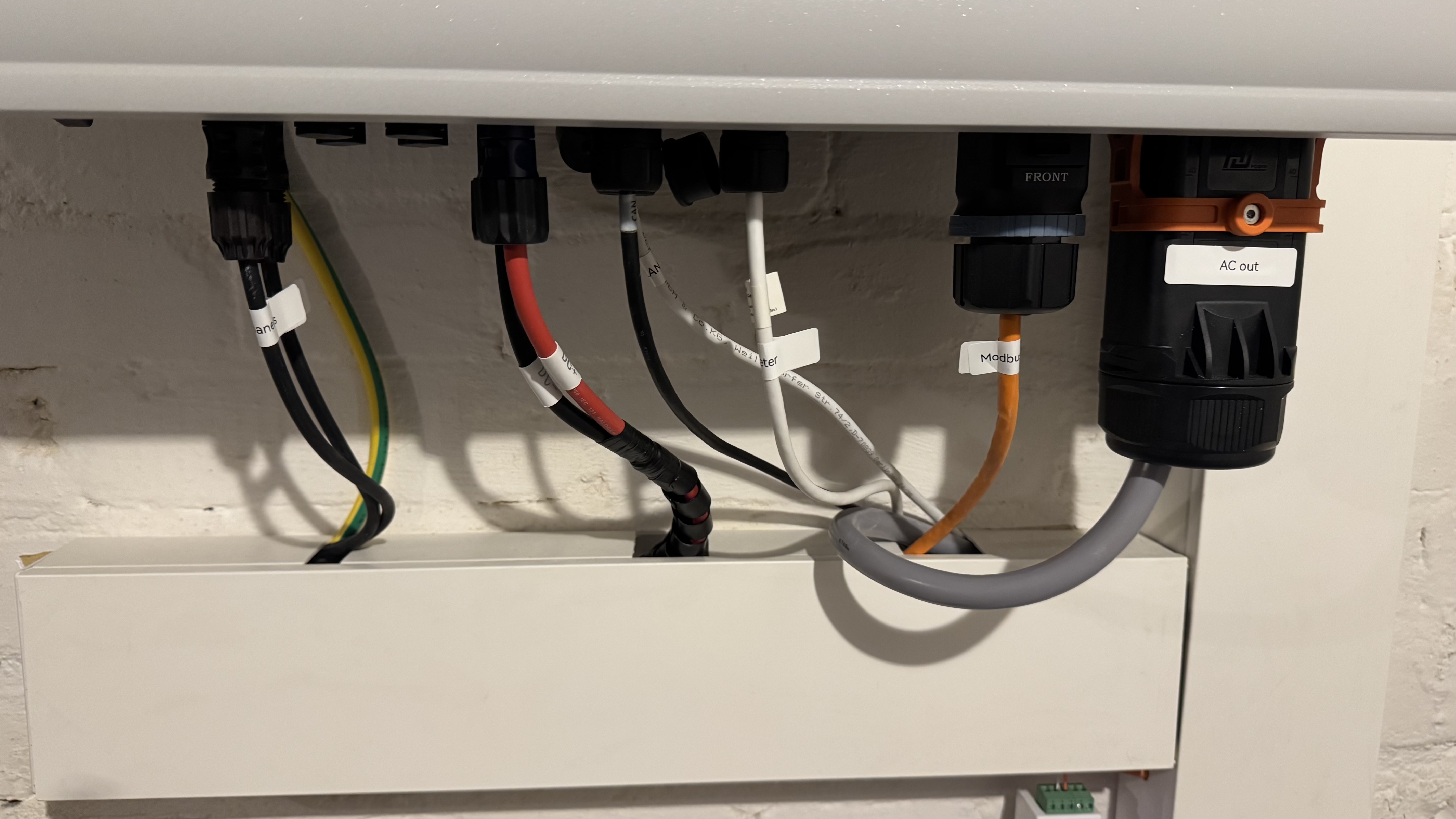

So these are my connections - the Modbus connector is the second from the right:
