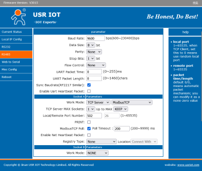

Right, so I got the 410S connected up and working this evening
In the end the biggest drama was working out how to get the COM port connector apart so I could connect the cable. After that I had to uh, "interpolate" from the W610 guidance, since there are options in the 410S absent from the W610 and vice versa. Anyway, the finalised and working config looks as follows:
I'm quite sure you could change the TCP Server MAX Sockets value to something bigger, but I don't need more than one since there's only one system (my HA VM) that will be talking to it.
I had already prepared an alternative YAML file and INCLUDE line in configuration.yaml, so a quick add and delete of a # and a restart of HA and I'm running on RS485 derived data, which is a result.

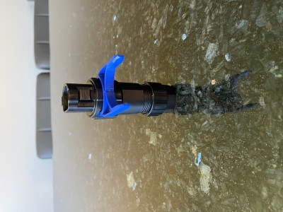

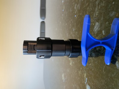

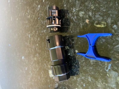

The inverter comes with a plastic tool that makes this easy, it’s basically plastic ‘U’ shaped tongs that push through the slots on the side of the connector and push the clips back - you can achieve the same with a medium sized pair of flat bladed screwdrivers pushed in the slots. The connector then comes about but has a bit of resistance from a rubber washer that stops water getting in.
I’m away from home today, back tomorrow - let me know if you’re stuck and i’ll take a picture of the tool and the connector to show how it comes apart.
I don't appear to have such a tool in the spares the installers left behind, so I guess it'll have to be the screwdrivers method.Dave Foster wrote: ↑Wed Apr 19, 2023 2:52 pm The inverter comes with a plastic tool that makes this easy, it’s basically plastic ‘U’ shaped tongs that push through the slots on the side of the connector and push the clips back - you can achieve the same with a medium sized pair of flat bladed screwdrivers pushed in the slots. The connector then comes about but has a bit of resistance from a rubber washer that stops water getting in.
Not sure which slots you're referring to on the connector. A picture would be very helpful, thanks.
Here’s a couple of shots of the connector, the tool and how it pushes the tangs you can see inwards (you can use flat blade screwdrivers) and the final disassembly.
Click on the pictures and they will rotate to correct orientation
Hope that helps !
Yes that made it nice and easy. Now connected to my Pi via RS485-USB and picking up all the sensor data in Home Assistant
