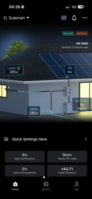

KH9.9 (8kw) + EQ4800 (42kwh) not using full battery but pulling from grid
Anyone have any idea why my full battery is not being used to service the house load but the system insists on puling from the grid. it was working fine and then i swapped over to Amber Energy (Australia) and its been playing up

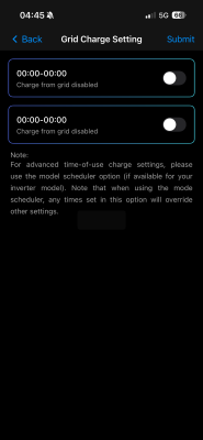

Not personally familiar with Amber but not taking power from battery usually indicates a schedule is running that has raised the minSoC (battery reserve), or set the work mode to ‘backup’ rather than Self Use, it can also be as a result of a Grid Charge period set without ‘charge from grid enabled’, if you are not using these they must be disabled i.e. set to 00:00-00:00.
Re: KH9.9 (8kw) + EQ4800 (42kwh) not using full battery but pulling from grid
Yea def no grid charge enabled. I’ve read about it happening to others but no real fix yet. Might have to update firmware.

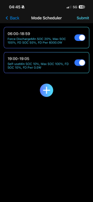

These are my current settings and you can see full battery and still pulling from grid.

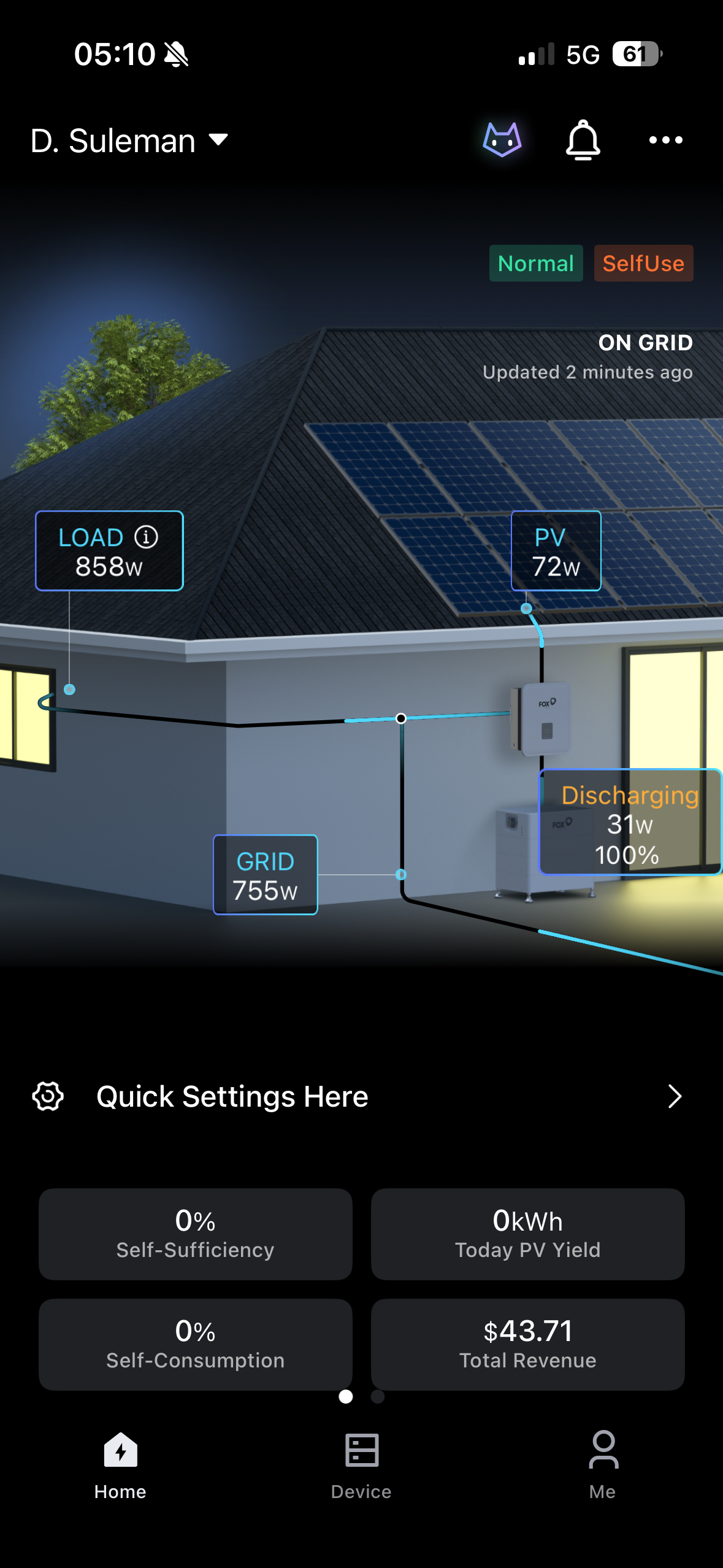

And then as soon as there’s a tiny amount of PV coming through, the battery stays doing something but not all of the load. I’m stumped :(

In your 2nd schedule, you have 0W as your FD Pwr.
In the past, this would allow system to convert your systems power for DC/AC conversion.
I believe a while back, this swapped to a literal setting, so you may have 0W of DC being converted to AC from your battery.
Try setting this to 8000W (or whatever your inverter spec can convert)
EDIT: I just realised that Amber is one of those VPP companies, that seem to take control over your system.
You are probably going to have to reach out to them for support I suspect.

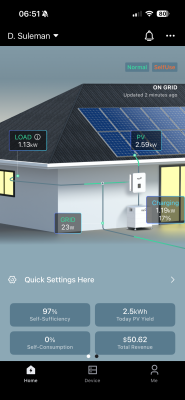

Just one question. See image below… why would 270w be missing… numbers don’t add up from what solar is feeding to house and charging battery? That 23w is grid incoming which I can’t change.

Your missing energy might be what your Inverter is using itself, or losses from converting DC to AC (for house load)
