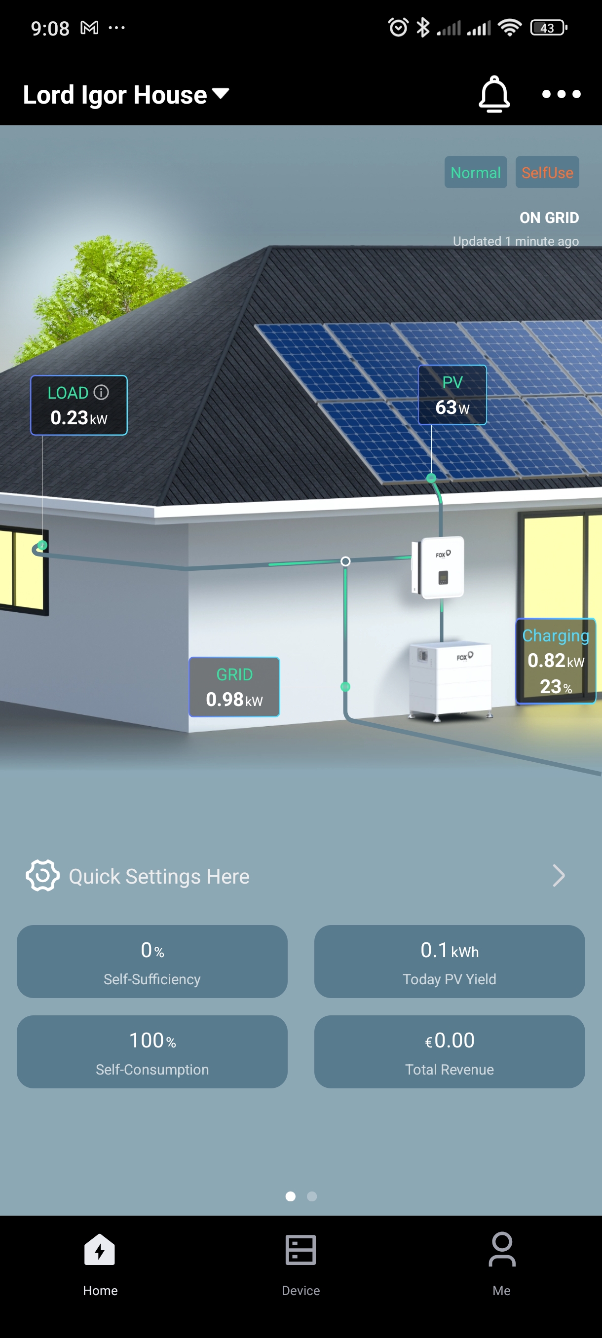

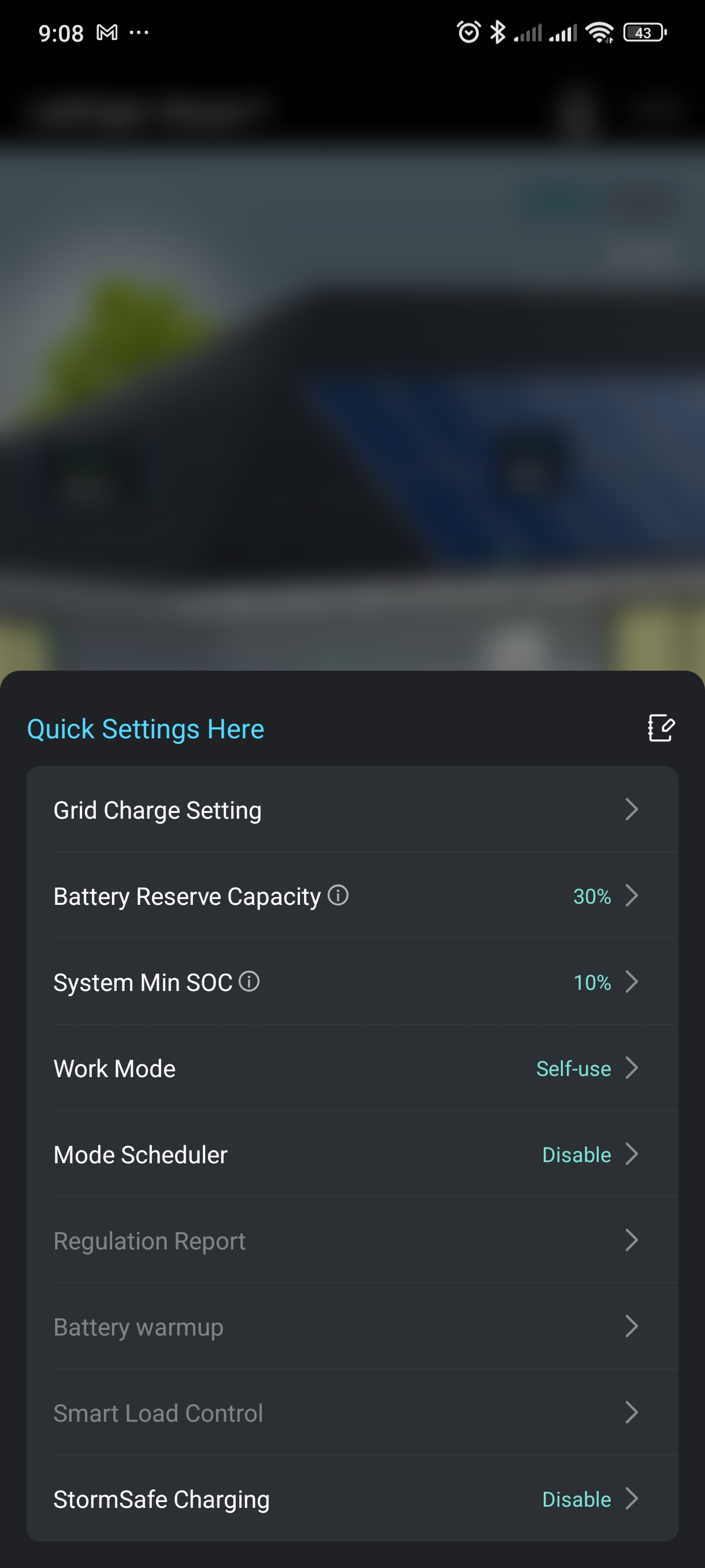

Since weather report showed the possibility of some clear skies between cloudy and rain showers, I decided to change Battery Reserve Capacity to 30% with the sole idea of profiting from some storage from PV generation when the skies cleared.
Logged into FoxCloud v2 app for changing Battery Reserve Capacity to 30% (battery SOC when I did this change was 16% due to a power outage that had ocurred yesterday).

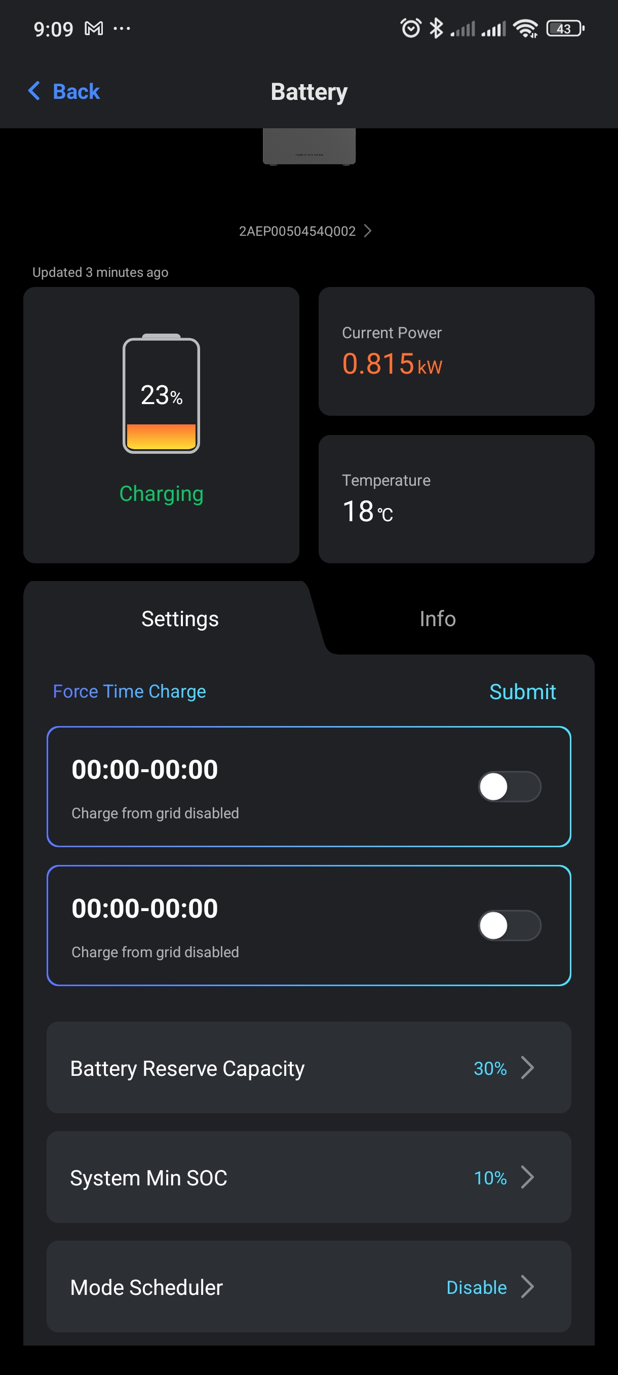

The moment I did that change, system started charging battery from grid, which I did not expected it to do, considering the setup above (selfuse mode, Mode Scheduler disabled, no Force Time periods set)!
I enclose some screenshots.
What am I missing here?
Any sugestions are more than welcome!

By setting minsoc higher than your battery soc the battery by design will immediately begin a slow maintenance charge from grid as the minimum it is allowed to go has been passed. Minsoc and minsoc on grid should normally be left set at 10%

If you raise your battery reserver higher than SoC it will ALWAYS (i.e. in every generation of Fox inverters from the beginning) take power from grid if there is not enough PV (it's not a bug, it is by design).
If you are in interested in the detailed mechanics of it the BMS will do a maintenance charge at 5A DC to get the batteries above battery reserve, so to get the power it will charge at you have to multiply your battery volts by 5A.
MinSoC is the minimum setting you want your battery to go to, the manufacturer recommends this to be 10%
MinSoC on grid (now called Battery Reserve) is only set differently to minSoC if you have an EPS installed and need to reserve some power should the grid fail - the difference between this and minSoC is your ‘reserve’.
You normally only change these settings if you are trying to stop the battery discharge below a certain level and not go below it (hence the reason why the system charges it from grid if you set a higher level, think of it like a bucket that must maintain a level of water) - if there is adequate PV it would use that instead, if not it will be grid.
MaxSoC is usually used where you want to limit the maximum amount of charge that goes into the batteries - if you set a force charge with your MaxSoC set to 30% it will only charge to 30% either from grid or PV if available.
If your minSoC is set to 20% and your battery SoC is dropping to 16%, that suggests your batteries are not properly balanced and the batteries are passively balancing. This is because the SoC figure reported by the BMS is actually a virtual number and is calculated from the battery cell voltages but there are dozens of cells in the battery (hence the balance required).
With LFP batteries the cell voltage change is very flat for the majority of the discharge and falls rapidly at 10% and increases rapidly at >96% - this is when the BMS re-validates it’s estimate. The recommendation for battery balancing is that you do a 100% charge at least once a month, and this will correct your SoC accuracy.
