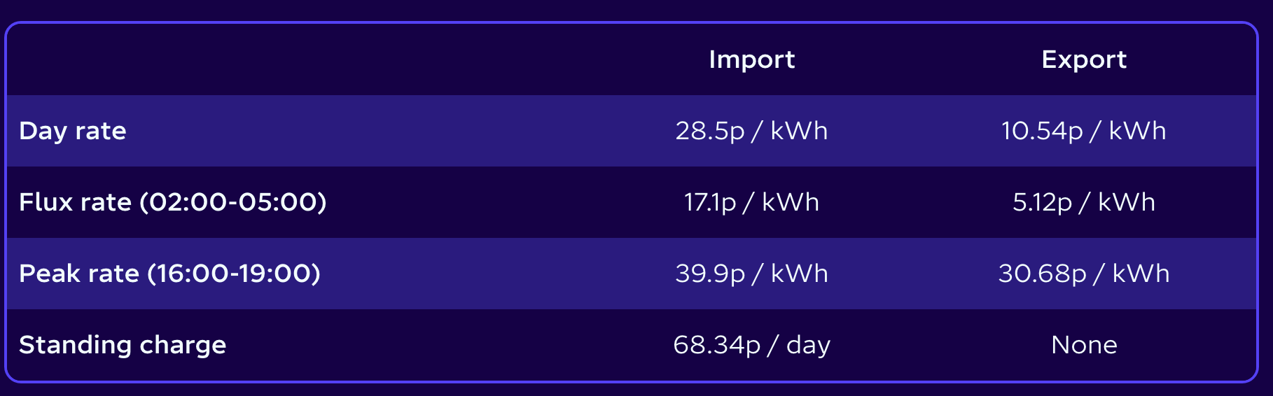

I am new to FoxCloud2. I would like some help with setting the work mode and mode schedules to optimise the benefits of the octopus flux tariff. This tariff has these rates:
Can someone explain how the work mode and schedules should be setup?

02:00-04:49 - Force ChargeMin SOC 10%, Max SOC 100%, FD SOC 100%, FD Pwr 3700W (Flux 17.10p Import rate)
16:00-18:59 - DischargeMin SOC 10%, Max SOC 10%, FD SOC 10%, FD Pwr 3700W (Flux 30.68p Export rate)
I am trying to force a discharge between 16:00-18:59. The trouble I was having was the battery disharging before 16:00 so wasn't exporting 100%
It was also charging after 7pm to 100% before 2AM so I was not taking advantage of the low rate between 2-5AM.
