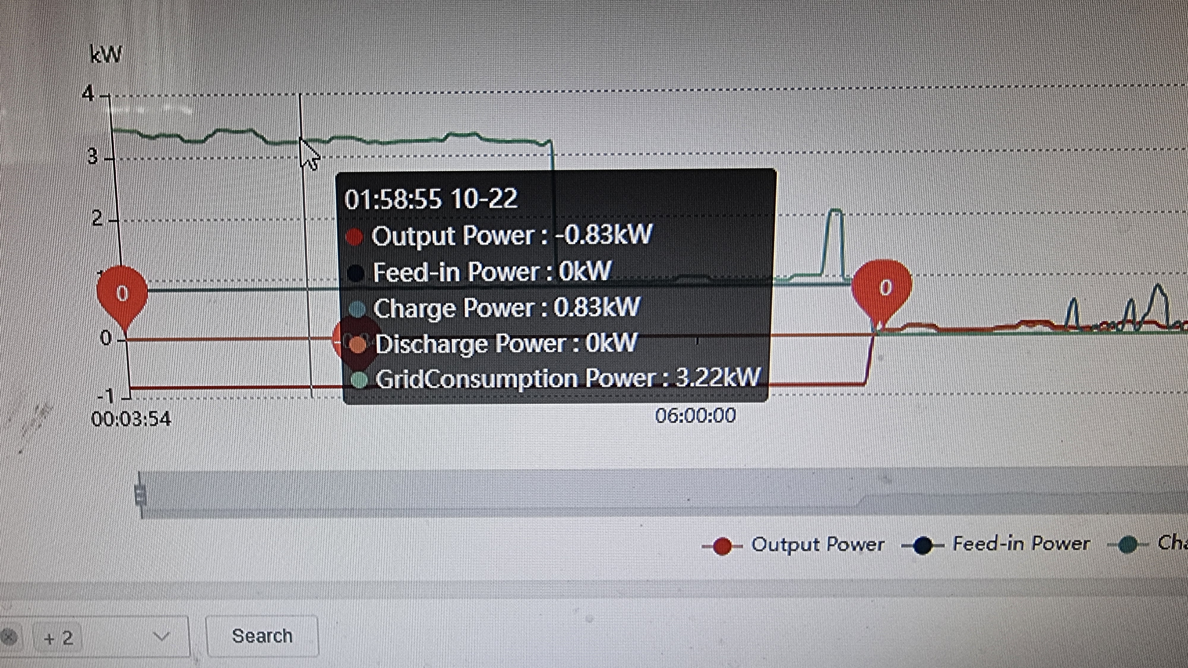

Hello, I have a Inverter Model: H1-5.0-E-G2
At night, when grid rates are cheaper in Portugal, I take advantage of the opportunity to charge the batteries via the grid. I've noticed that the charging power is always the same, i.e., it constantly charges at 0.83 kW. Is there any way to change this value? Thank you.
chart details
chart details

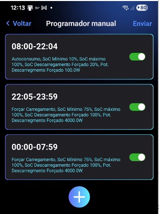

app settings
app settings

On your Force Charge schedules leave your minSoC set at 10%, as you have set it (75%), the batteries will only charge at 5A (DC) rather than the full power available using the Force Charge.
Re: Power battery when charge from grid
Dear Dave Foster, I have it at 75%, because if this value is below the battery value, I simply don't receive power from the grid. Example: if the battery is set at 22% and the minSoC is at 10%, I don't receive power from the grid. If I increase the minSoC to 30%, I receive power from the grid and it stops when the battery reaches 30%. Could it have something to do with the firmware?

For some reason the normal force charge isn’t working, but the low power charge is - it’s probably best to start by getting your firmware updated as it is very old, latest Master is 1.45 and Manager 1.62
Once you have the latest firmware we can then walk through the inverter settings that could interact to slow down your charge rate such as ‘maxchgcur’ and ‘importlimitpwr’ - both of these can effect the charge speed.
