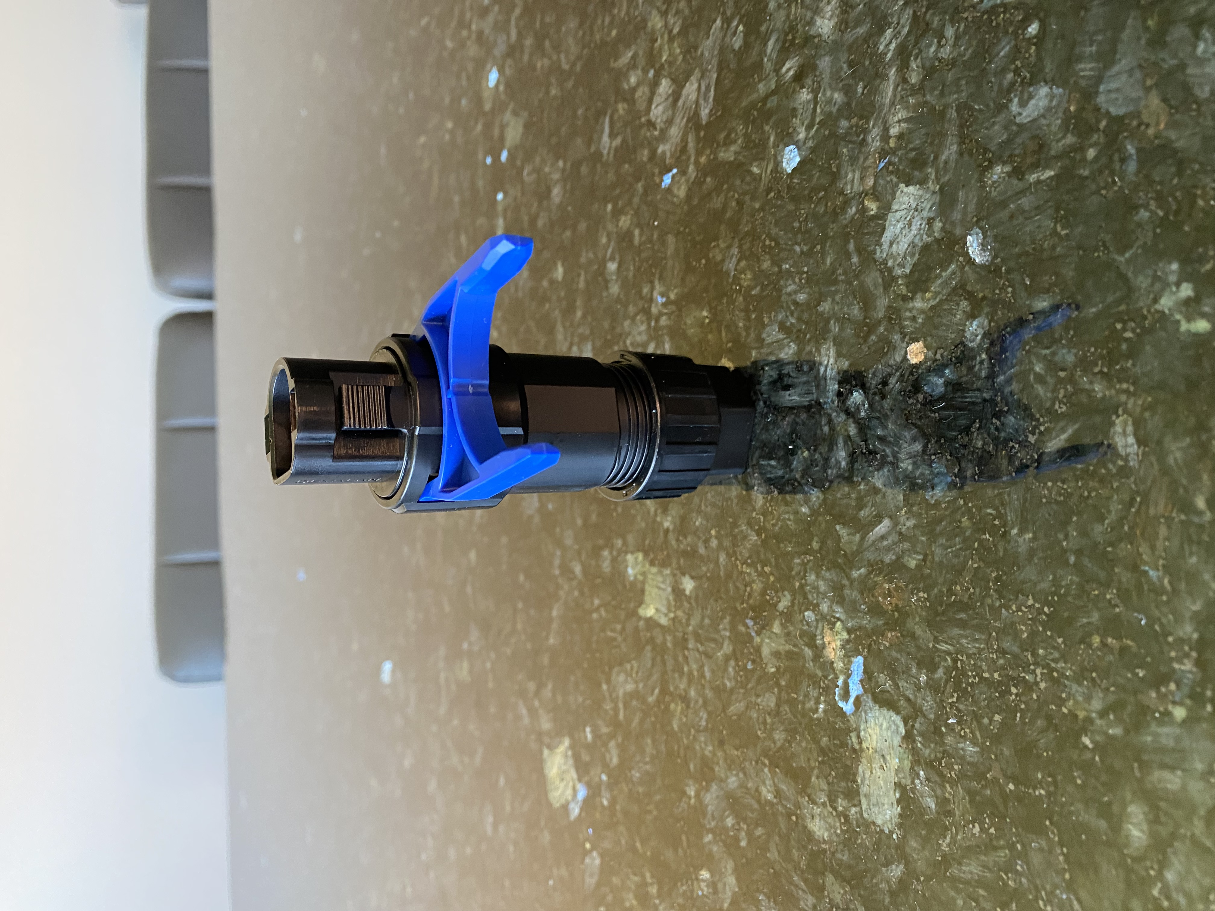

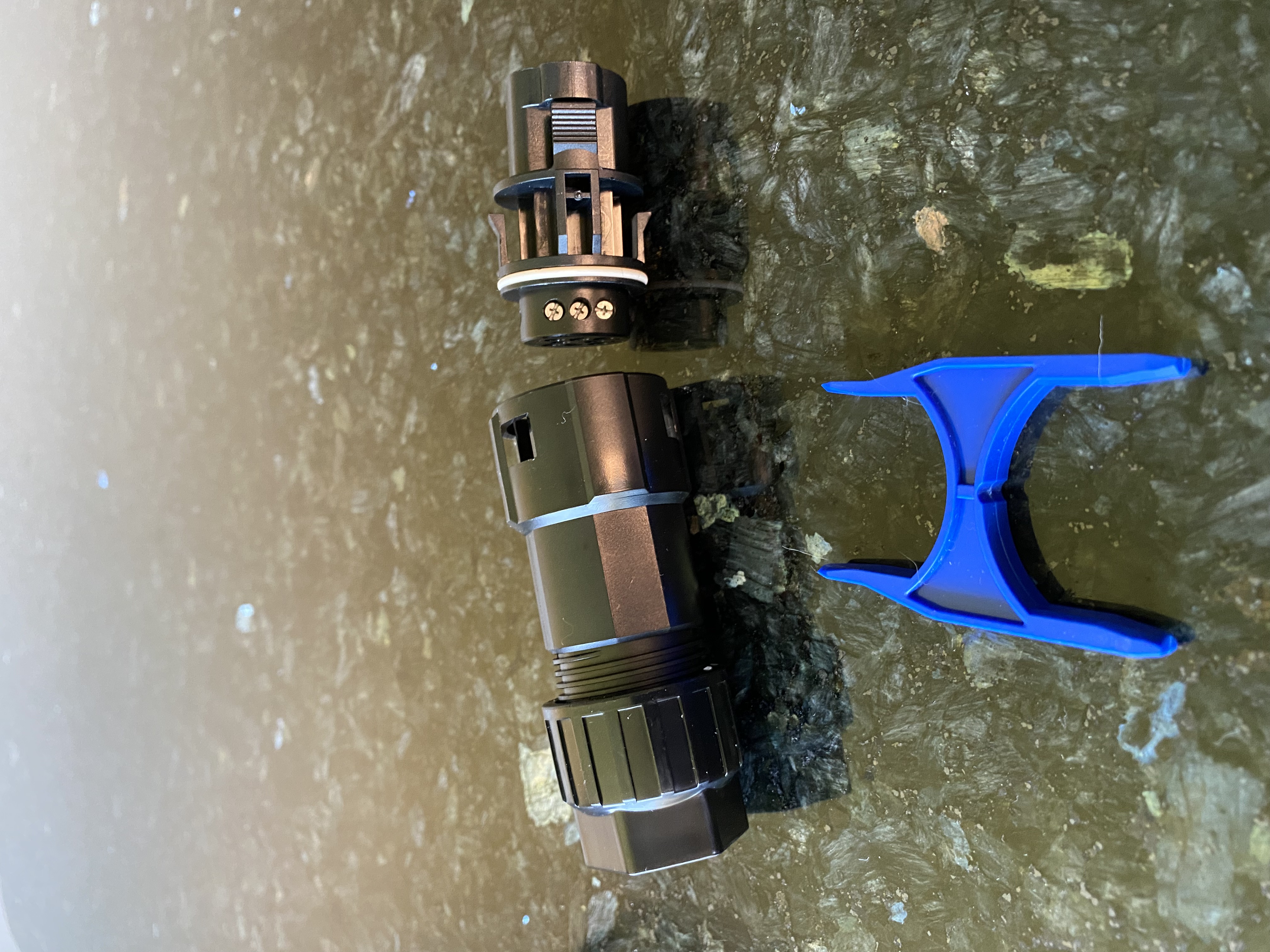

In the end the biggest drama was working out how to get the COM port connector apart so I could connect the cable.
How did you get it apart?
I’ve tried prising it with a screwdriver and mole wrench without any joy and don’t want to break it!
Any advice appreciated

The inverter comes with a plastic tool that makes this easy, it’s basically plastic ‘U’ shaped tongs that push through the slots on the side of the connector and push the clips back - you can achieve the same with a medium sized pair of flat bladed screwdrivers pushed in the slots. The connector then comes about but has a bit of resistance from a rubber washer that stops water getting in.asjp100 wrote: Wed Apr 19, 2023 2:39 pm How did you get it apart?

Not sure which slots you're referring to on the connector. A picture would be very helpful, thanks.
- Posts: 1786
Here’s a couple of shots of the connector, the tool and how it pushes the tangs you can see inwards (you can use flat blade screwdrivers) and the final disassembly.asjp100 wrote: Wed Apr 19, 2023 5:05 pm I don't appear to have such a tool in the spares the installers left behind, so I guess it'll have to be the screwdrivers method.

Click on the pictures and they will rotate to correct orientation
Hope that helps !
