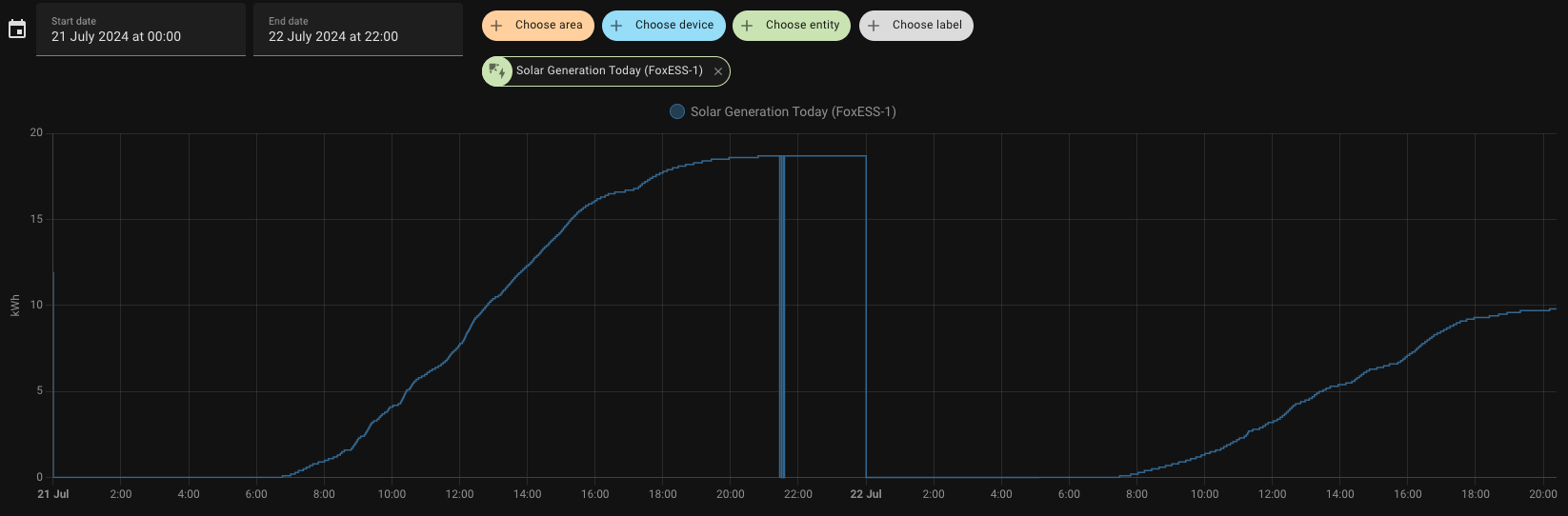

I have H1 integrated with HA via Waveshare modbus. @Dave Foster helped me setting all this up, as I have made few small mistakes when building the solution... I now have a working integration with a lot of stats in Energy dashboard of HA. HOWEVER, there is a daily random spike of solar generation that I have difficulties explaining - usually happens between 21-22.00. Spike indicates between 18 to 40kWh generation that never happened, but it breaks all the statistics... I know how to correct this in Dev tools but it is boring to do that every day... This spike does not come from the inverter - H1 web statistics do not show similar spike...
I did a bit of a research and I've found posts in HA forum, dated 2022, with similar issues on different inverters... Response from some forum users was very patronising "fix your sensor" with extremely scarce information how to do that... As i use Modbus integration I have no idea where my sensors are defined and if I could "fix them" anyway... Apparently it is something to do with sensor availability...
From where I sit it does look like the issue is with HA or modbus integration but I am happy to be corrected here...
Would anyone like to discuss further??
What's with the spikes??

I've just noticed you have posted on another thread that you are looking for batteries, do you currently have any batteries on this system ?
The timing looks spookily about the time that there is not enough voltage on your PV and without batteries the H1 would normally go into standby ('waiting') - i'm not sure what would happen on the modbus when that happens but are you able to show the trace of one of the sensors for the hour before and after the 'spike' occurs.

Hello @Dave,
you are correct. I did post indeed. There are no batteries on the current system. I am in the process of securing funds from my "finance director"...
Where do I get those traces, are those the generation graphs from the modbus entity you're referring to??

You can see all of the sensors that the integration is providing by clicking on Settings, Devices & Services, find the Foxess-Modbus integration and click on '1 Device'
That will list all available sensors, if you then click on the one that says 'Solar Generation Today' it should open a history graph on the screen.
There's a link in blue that says 'show more' and when you click that it will change to allow you to enter a start and end date/time range - if you pick a day where you know it has done it and set the start date/time an hour before, and the end date/time an hour after and click on the select it will draw the graph for that period of the Solar generation sensor, can you screen shot the graph and attach it below please so we can see what the sensor is doing.

Is that what you need??

Looking at the trace, I think that would cause trouble when the inverter is shutting down once there isn't enough solar left to keep the MPPT up.
It looks like the trace is going up and down several times, I assume as the inverter is detecting enough voltage threshold to start up, before it then shuts down again - each one of those to zero and back to positive will result in the energy dashboard think you've just had a load of solar power.
The state_class of the sensor is total_increasing, so a lower state (even from e.g. 10 to 9) will be interpreted as a reset of the sensor, HA will think the sensor has been reset to 0 and then increased to a new value again. The long term statistic will then use the value it was plus the value it now is and that means because the sensor has gone to 0 temporarily, it will double when it returns to the correct state.
If the sun goes down quickly it won't happen, but most importantly once you have batteries fitted the hybrid will never shut down as it stays operational from the batteries.

Thanks for that. Could that be fixed in any way or is it something I have to leave with for now??

I think it's possible to work round it, but you'll have to do the calculations rather than rely on the solar generation register that comes directly from the inverter.TheDomOfThree wrote: ↑Tue Jul 23, 2024 12:09 pm Thanks for that. Could that be fixed in any way or is it something I have to leave with for now??
If you add this to your configuration.yaml under the `sensor:` section
Code: Select all
sensor:
- method: left
platform: integration
round: 2
source: sensor.pv_power
unit_time: h
Code: Select all
utility_meter:
daily_pv_sum:
source: sensor.pv_total_sum
cycle: daily
always_available: true
What this will do is to use the inverter 'PV power' sensor as the source for a Riemann sum that integrates it over time and converts power (kW) to energy (kWh)
That 'sum' is then used as the source for a utility_meter which will reset daily at midnight and will never become unavailable so it's value should always be consistent.
Finally you need to go to Settings, Dashboards - click on Energy and under 'Solar Production' remove the sensors there and replace with `sensor.daily_pv1_sum`

Hello All,
just a quick summary. My previously mentioned possible fix was just a coincidence that did not last long... However I have configured the new sensor as per above post. Thank you @Dave Foster. Everything seem to be working exactly as it should be. No more random spikes etc.
@Dave if you keep helping me the way you do with my HA, I am gonna need to make a goat sacrifice or at least send some 6 pack your way...
Thank you very much again. I do have a question however. This type of issue seem to be very common. I have seen very old posts, in various places, referring to similar problems observed with different inverters... Any idea why wasn't the fix implemented globally yet?? It does not look extremely complicated. Am I missing something here??
